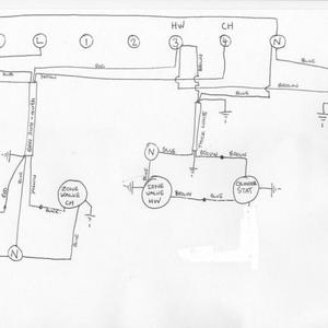

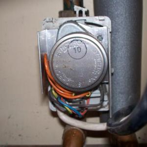

If the HW and CH are both on and the cylinder stat is satisfied the HW turns off, I can see this happen on the zone valve. However the CH stays on ie pump still turns, CH valve does not move, rads hot. Does this mean the microswitch in the CH valve is ok or do I still need to check it?
