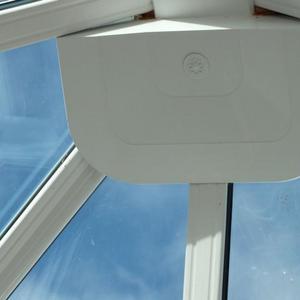

    Ultraframe roof system leaking
    ok i'll have a look although i am not entirely sure why you mean by crest and finials .yes the installer did you use expanding foam when complied about the dripping.Ill have to look at the booklet that came with it because i am not all, sure what you mean by "all box gutter" or "the bars on the...
    the pics I took are on this link but they don't really say much except there is tray more or less where the leak comes from but looking from the outside it does not appear to be full of water.That suggests to me the fitter was right when he said the drips were caused by condensation.We have had...

  15. ultraframe  roofing photos
