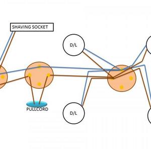

    Bathroom Wiring
    Sussed it, There was one duff connection, rewired it and everything's working perfectly, Thanks gents,
  2. M
    Bathroom Wiring
    Sorry John/Taylor, As posted my voltage tester is missing the battery cage so i can't check the voltage yet in the down light junction box, once I have and I've checked the connections ill let you know..... Thank you for all the pointers it's appreciated
  3. M
    Bathroom Wiring
    Hi spark, I believe it is, The middle junction box I left in situ but disconnected the pull switch and the leg going to the third junction box to make safe all wiring into the bathroom..... I'm hopeful it's going to be a schoolboy error along the lines of having a duff connection in one...
  4. M
    Bathroom Wiring
    No dimmer Taylor, i have heard that dimmer technology/pricing is yet to catch up with LED technology, I've just realised the battery door for my Kewtech 1700 is missing!!! Anyone know where i might get a replacement one? (I've sent Kewtech a grovelling email)
  5. M
    Bathroom Wiring
    Thank you for the swift reply chaps, Yes Taylor they are all 230v LED Downlights, Yes John the earths are there except where the legs run out to a downlight (D/L), there is no where to terminate the earth on the D/L I think i will have to open up the junction boxes and double check the...
  6. M
    Bathroom Wiring
    Afternoon all, don't you just hate easter, all those adverts advising it's a great weekend to finish/start your next DIY project........ well i decided to try and finish some lighting so i could continue painting into the late hours but ive hit a problem...... I need some help/advice on a...
