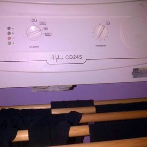

    Alpha CD24S losing pressure / high running pressure
    Eh??? It's a CD24S. I'm going off the label on the front of the boiler (see photo) and the documentation supplied when it was fitted. [/img] The expansion vessel is at the rear (and inaccessible). I don't know where the CB version and left mounted tank came into the equation. Despite...
    All done, no new vessel needed after all :). In case it helps anyone else, here's how... I took a 6 inch piece of 15mm copper tube and crimped the end so it was a tight fit on the valve cap - I could then turn it from the top of the boiler and the cap came away lodged in the pipe. I tried...
    God help you if you have something more difficult than this! It's behind (not to the left) and 5 inches down from the top of the boiler which is 4 inches from the ceiling; how stupid of me, I naively thought it might be accessible to human beings. It explains why the manual glosses over how...
