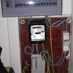

    Should I ask for a new meter?
    E-on recently came out and fitted a mains isolator between my meter and my new board. There was a problem with one of the terminals on the outlet side of the meter -I think it was knackered and I noticed he has run one of the tails directly from the mains fuse to the isolator. Is this ok?
