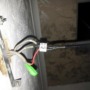

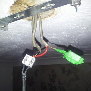

  9. 1
    Light switch trips main breaker
    I tested continuity between all of the wires and the metal bracket and they were also open circuit. I then stripped off the electrical tape and put more on and its definitely covered. I then snipped back the wires so that none of the copper was showing and tried again, but no luck it still...

  11. 1
    Yes with the wire in the terminal block I can operate the switches without the breaker tripping. If I put my multimeter across the live input and output of the transformer on resistance will I be able to check continuity of the circuitry that way?

  13. 1
    Yes I just connected live-live and neutral-neutral. The switch was never disconnected so they have always been in the state that they are in the pics. I have a multimeter and know how to use it. I have put each of the wires in some terminal block with the light disconnected and tried...

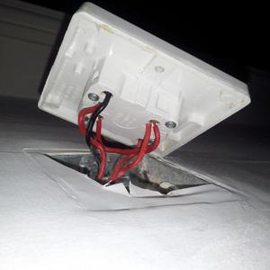

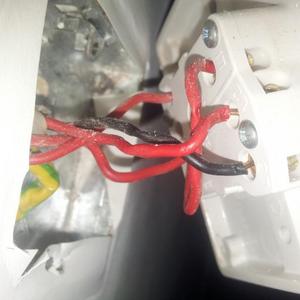

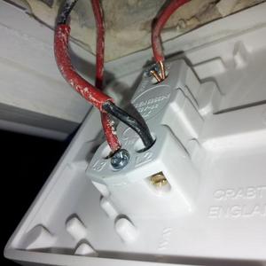

  14. 1
    Yes I've looked in both but the only thing that seemed possibly wrong to me was the 'upside down' switch. The single switch you can see where the wires go but on the double one there are red wires going in to top L2, bottom L2 and L1 and then a link between the 2 L1's. There is a black wire...

  17. 1
    Yes there's quite a few others that work fine. I have just taken off one of the switches and although you can't see it in the photo the word 'top' is facing downwards. Am I right to assume this could be the cause even if the other light on that same switch works ok even being upside down?
