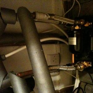

    Stuart Turner Monsoon Universal 4 bar twin - HUNTING
    Also a picture of the said pump http://www.diynot.com/network/woodfordma/albums/10239/38631

  5. W
    Morning all So this morning I left the house with the mains stopcock shut, the kitchen cold tap on and all mixer taps off but over to the cold side. This should give it at about 12 hours before I go home to check the results. The washing machine is connected to the cold for sure so that...

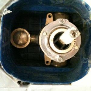

  7. Shower mixer
    Shower mixer

  9. W
    Luckily my boxing in isnt that serious! Only the colder water storage tank is boxed in and everything else is accessible. Although how do you isolate a shower? Tomorrow, before I go to work I will close the stopcock at mains, leave the cold mixers over on the cold side (but shut) and leave...
