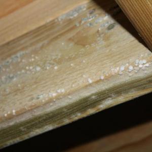

    Why is there fungus on my new ply roof (pics included)?

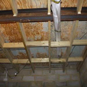

    No, I the parafin heater hasnt been used since but the door has been shut and there was condensation in there even after a whole week or so of not been in there. So putting in insulation does this remove the cold surface?

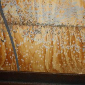

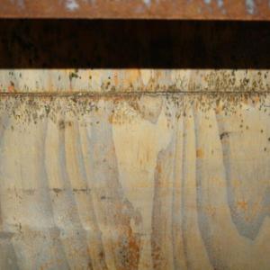

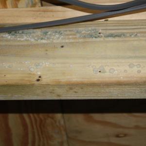

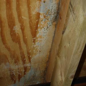

    Hi, Can anyone advise me if the above advise is still valid. My problem is getting worse and i feel if i just wipe it that it will still be there. See pics below of it getting worse. Cheers, Tony - - - -

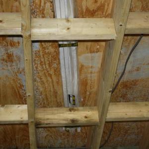

    Thanks for that? Is the vapaour barrier a paint or a sheet material? Tony

    So if i insulalate and put up plaster board it should be warmer and so i shouldnt get condensation? Also, should i clean the mold and paint it with something first to protect the shuttering ply?

    I am going to put space blankets in and then plasterboard for the ceiling. If i clean the mold will this problem get worse if I dont treat or paint the shuttering ply first and just seal it in? Cheers, Tony

    Will this come back? Are you sure its not damaged? Also, I was thinking about getting parafin heaters when my gym is complete (as ive been told its cheaper than electric) but i am thinking this is a bad idea!!!

    Hi, I have'nt finished my roof yet as I still have to put the insulation and plasterboard up but this morning I just noticed some fungus or mold or something. I am not sure what it is but it doesnt look good. I am building a gym so I dont think this would be good if i breathe it in. I...

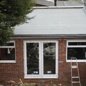

  17. Outside of gym
    Outside of gym
    two layers of felt on the roof
