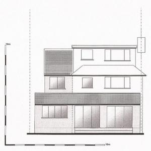

    there is only the back view and the floor plan of the new ground level. is that what you are asking for. also i just measured the architect scale. 1cm on the ruler is 9mm on their scale. grrrr... i will also post on what we have actually built first image [/img]

    this is what stated in the officer report. In which he refers to the GPD 2008 which is where we got the definition of ground level. He then says that doesnt apply as its not PD. Analysis - single storey rear extension Impact on Surrounding Area As noted in the previous application, due to...

    sorry new to forum posting. thanks for posting up. the height measurement for the 3m slope has been taken from the existing house at the highest point to give a consistent floor level. with regards to the fence line its not shown, what does this mean? enforcement in the post apparently...
