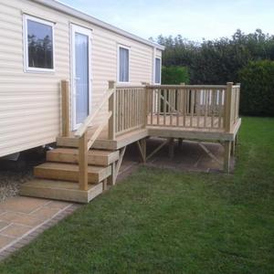

  16. work pictures
    work pictures
    A few pictures of jobs some before and after.
