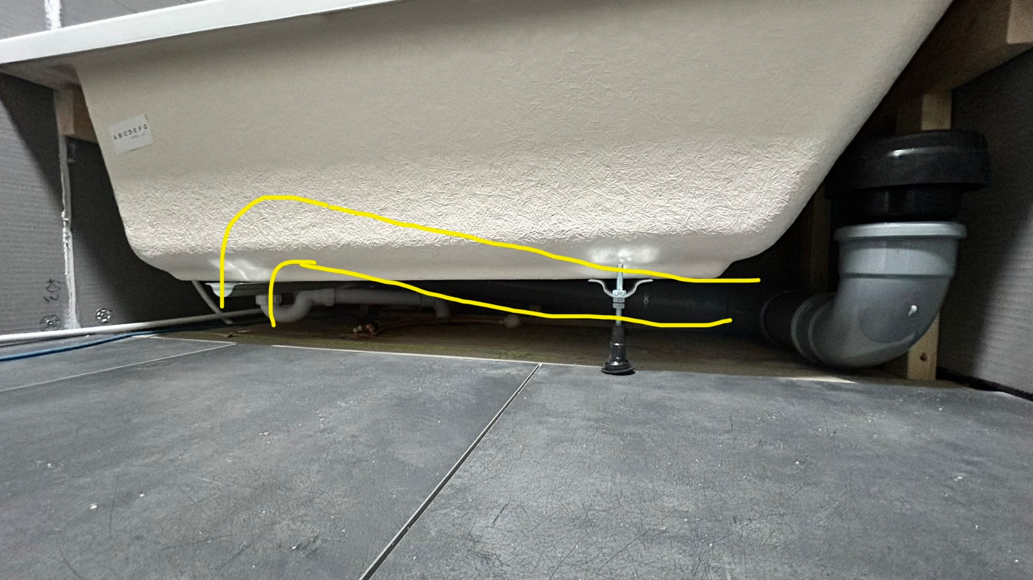

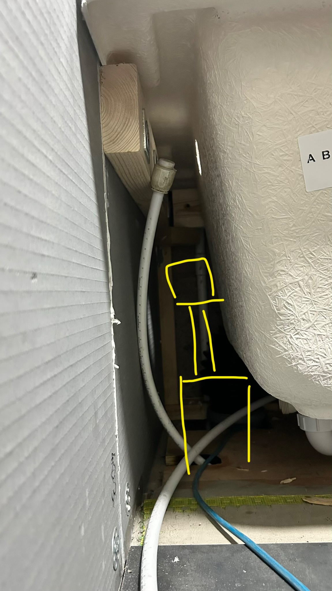

I am in a bit of a pickle with the AAV. The soil stack in on the left corner behind the bath (see pictures).
Previously there was a section of 40mm pipe on top of it with a small AAV. We never had a problem with it.
I understand 40mm don’t provide sufficient air flow (although we never had a problem) so I was keen to install a 110mm AAV.
There isn’t much space to install it directly over the soil pipe and even if I managed, it would be subject to splashes of water and difficult to access, so I bought a flexible 110mm pipe (https://www.screwfix.com/p/alpha-flexi-pipe-110mm-x-455mm/23342), a 1m section, a couple of bends and managed to get the AAV on the other side of the bath, which has more space for possible maintenance. The only problem is that the pipe is sloping downwards before reaching the AAV and I’m worried condensation could fill it with water with no means to escape, blocking airflow and making it useful.
There are no options to extend the 110 mm pipe up to the roof.
My only options are:
- 40mm vent on top of the soil stack: it should be accessible for maintenance for someone with long arms
- 110mm vent on the right side of the bath: fully accessible, but condensation might occur (?)

40mm AAV should be enough for what it needs to do, if you still want to upsize, try a 50mm version. By your own admission you have never had an issue so I rather think you are making unnecessary work for yourself.

Go with the 40mm straight up off the stack. You want the AAV as high as you can get it, ideally above the flood level of the highest fitting, and a vertical run avoids the whole wrong slope worry entirely. The 110mm across the bath will work but any sag in that run will hold condensation and slime up over time. 40mm has vented that stack fine for years so I would not overthink it.

As other have suggested though if you haven't had issues with the 40mm up till now then no reason it should cause issues in the future, if you continued to use it.
