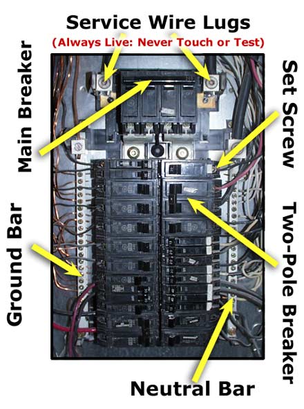

I really hope that pictured CU isn't for a whole house... no way are those conductors out of the breakers meaty enough... ESPECIALLY not at 120V.
Is there a cover that fits on, leaving the breakers available? Only the "Service Wire Lugs" are right where your hand will be when you try to flip on the main breaker! Perhaps some kind of clip-on plastic cover is in order for the terminals? Designed so you can't get anything in there with the covers in place.
Do they call them CUs over there or is there another name for them?
