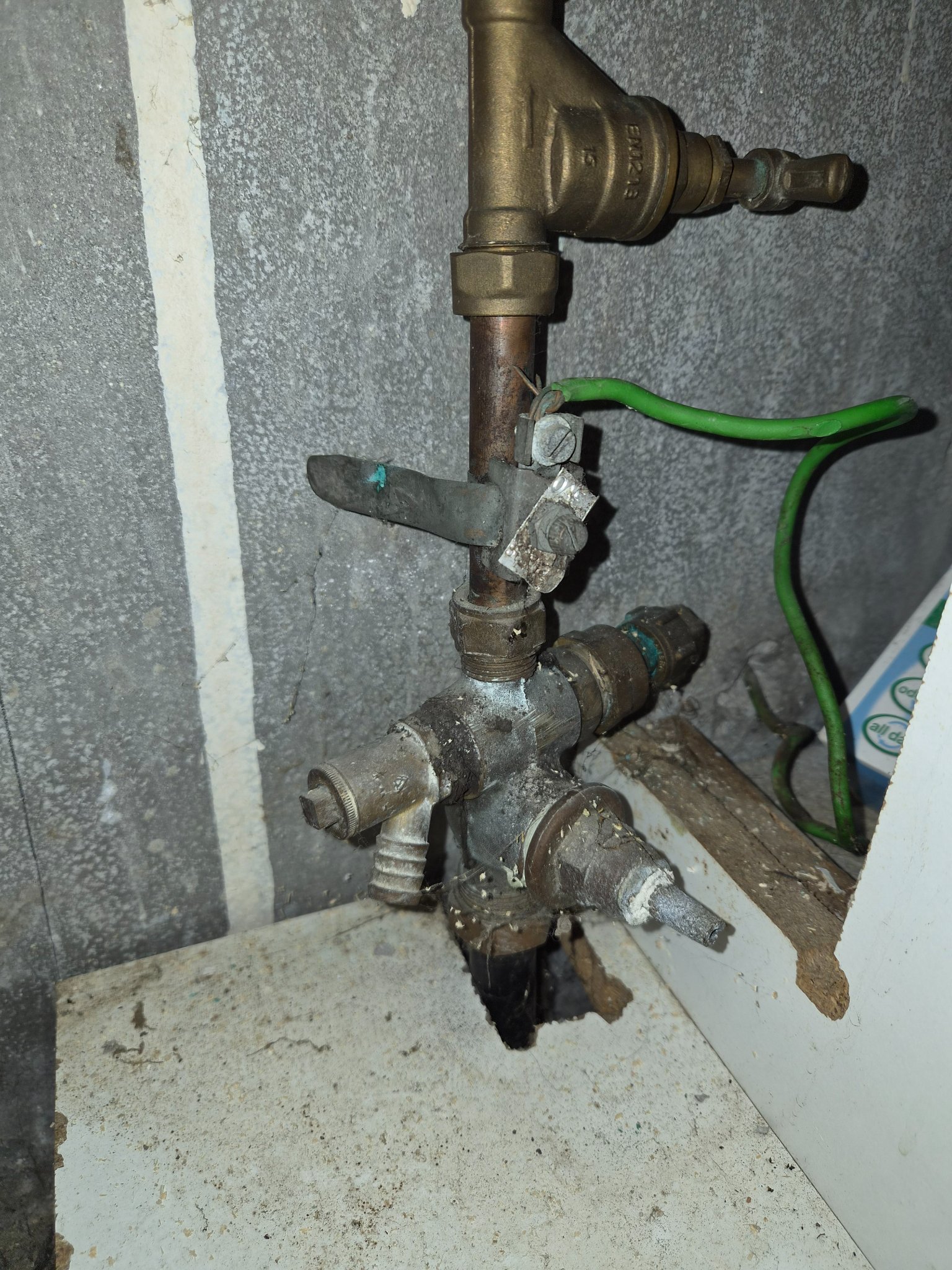

Hi would anyone be able to tell me what the bottom valve/fitting is below the stop cock? And what is the purpose of it?

An old combined stopcock and draincock.
Turn water off then the bit on the left you attach a hose then open to drain water.
I guess it's seized so a new stop cock was fitted above
