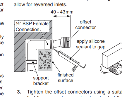

Just ripped out my old shower/tiles/plasterboard etc.
Piped in the hot & cold at 150mm centres.
Looking at some showers (Mira & Grohe etc), they seem to have a 1/2" BSP connection inside the wall?
I was just going to stick the 15mm copper tails out through the wetwall then thought they've be cut back to a certain size and then a compression fitting to the bar mixer?
Mira relate drawing below
thanks, thats what i was looking for, the picture above was throwing me off.
