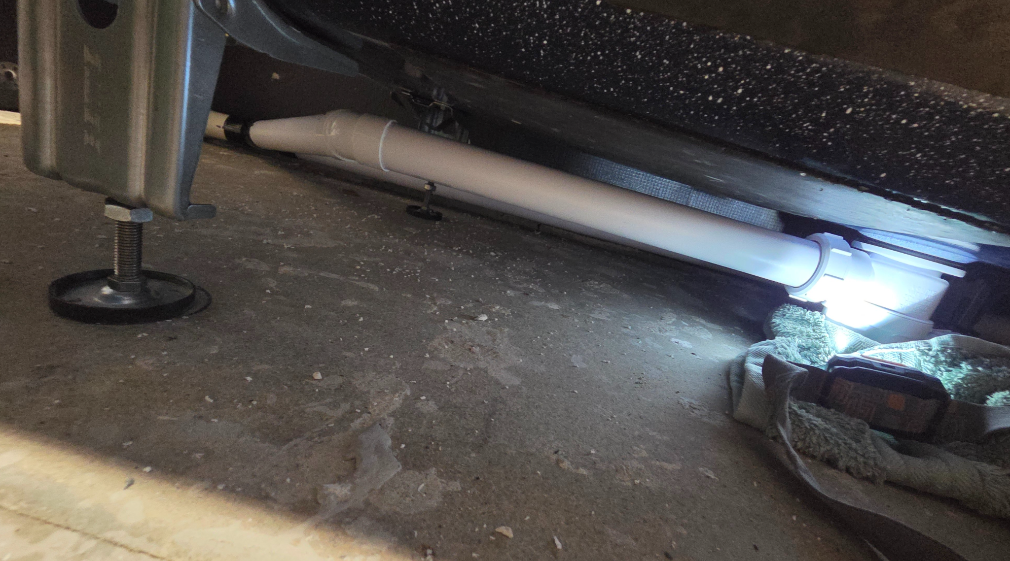

I am installing a new bath with Mcalpine HC2650 and the hole for this bath is in the middle of it.
My stack outlet is in the direct corner so ive done a small straight run then a 45 degree run to the stack.
Will I have enough drop on the first section to avoid long term issues as the bath will be tiled in so inaccessible.
The bath will be used as a shower so the next squillion years of my missus hair going down it!
Other thing us i will have top down access in the event of major issues frlm the trap to push through or retrieve hair.

Bit more would have been good but it shouldn't be a problem, it isn't very long.
Thanks, the thing drains well enough, I can always get some pressure down there one day if need be with this top down removable sink!
