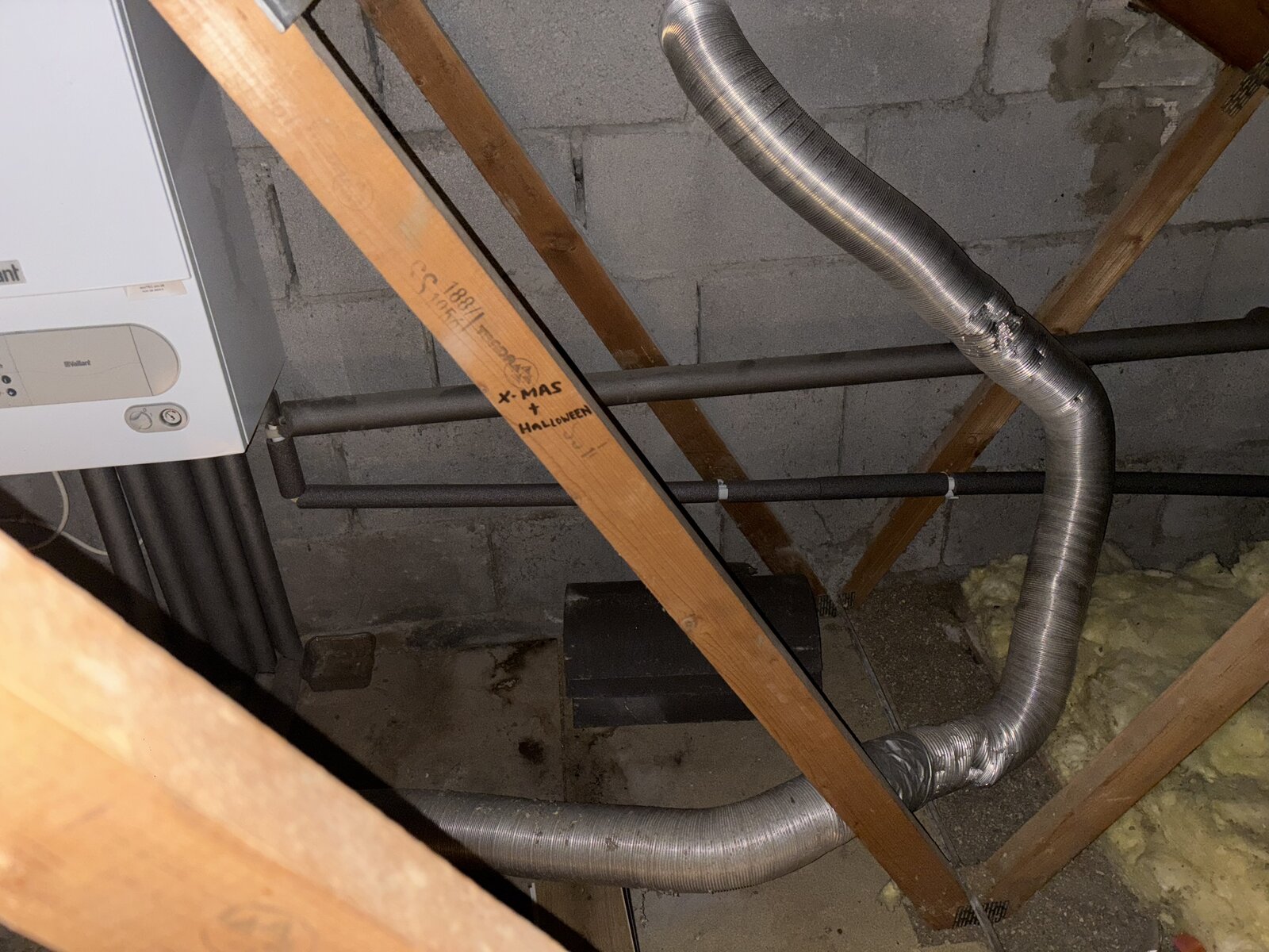

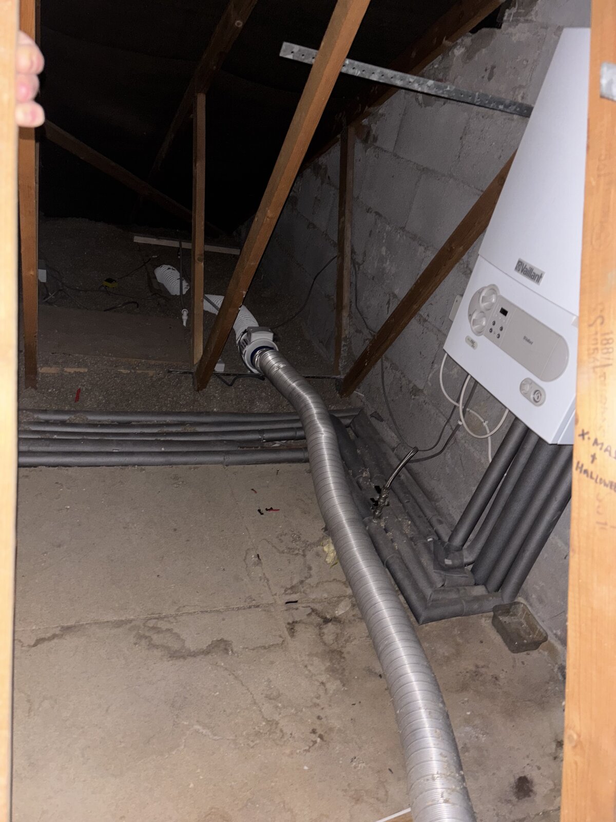

I have recently had a new extractor fan fitted in my bathroom as part of a full bathroom refurbishment. The vent is in the ceiling, close to the shower in the bathroom.
I have an 'in-line- extractor which is fitted in the loft with approximately 1.5 meters of plastic flexible ducting running from the bathroom vent, to the in line extractor. Then there is approximately 5m of flexible metal ducting running from the extractor to the vent on an outside wall (with a 1 metre climb).
The extractor fan doesn't seem to extract much of the steam when using the shower so I am looking at possibly making some improvements to the venting to make it more efficient.
Firstly, I could definitely shorten the length of the metal dusting by about 1 metre and run it on a gradual incline from the extractor to the exit point, (the attached photo shows the current ducting runs slightly past the extraction point with a kink, before a steep incline to the extraction point).
I may also be able to shorten the plastic ducting on the other side, so it can be stretched a bit tighter (if that makes any sense?).
I also read that it should probably be insulated so once I have finished re-routing/improving the ducting, I will then look to insulate it properly.

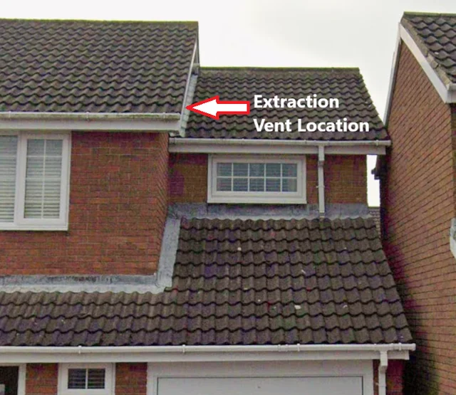

The exit point is on an external wall on the gable end- it cant be any lower due to an extension above the garage (see attached photo).

I used soil pipe as smooth and solid.
Needs to run away ( down) so any condensation runs away.
Constantina pipe creates a lot of air turbulence and restricts flow.
You can buy soild extractor pipe so you could use that.
Also check that your inline extractor is a centrifugal fan and see how far it will push air through the ducting in the specs.
Mine is about 6m
Before you mess around in the loft is their sufficient air gap under the door so the fan can draw dry air into the room from the house?
