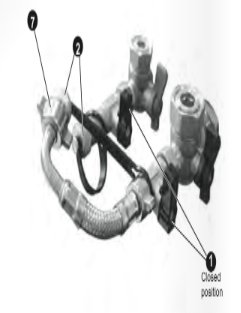

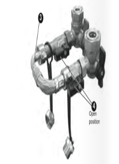

Not sure what they’ve been doing, messing around with the boiler but it’s reading the word bar. Instead of an actual number, the thing is at 6 o’ clock which is outside the numerical bar range.
Does this mean the pressure is too high? Or the pressure gauge isn’t reading pressure at all (shouldn’t it just be 0 then)?
It doesn’t respond to bleeding the radiators (it didn't go back down to numbers)
It’s a logic combi 30. I’m not at the boiler right now but here’s an old photo of it working photo too big and the pressure on bar - recent. The valve was turned like this but made them turn it back up
(water heats up but radiators don’t)

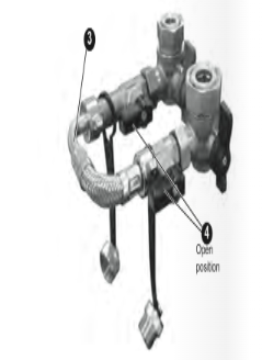

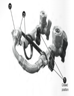

For the valves, everything should point upwards (I don’t know why.. I just don’t touch them) but the loop thing here should both be closed and only opened to increase pressure. So it should be right. It does this —|—instead of — - —
