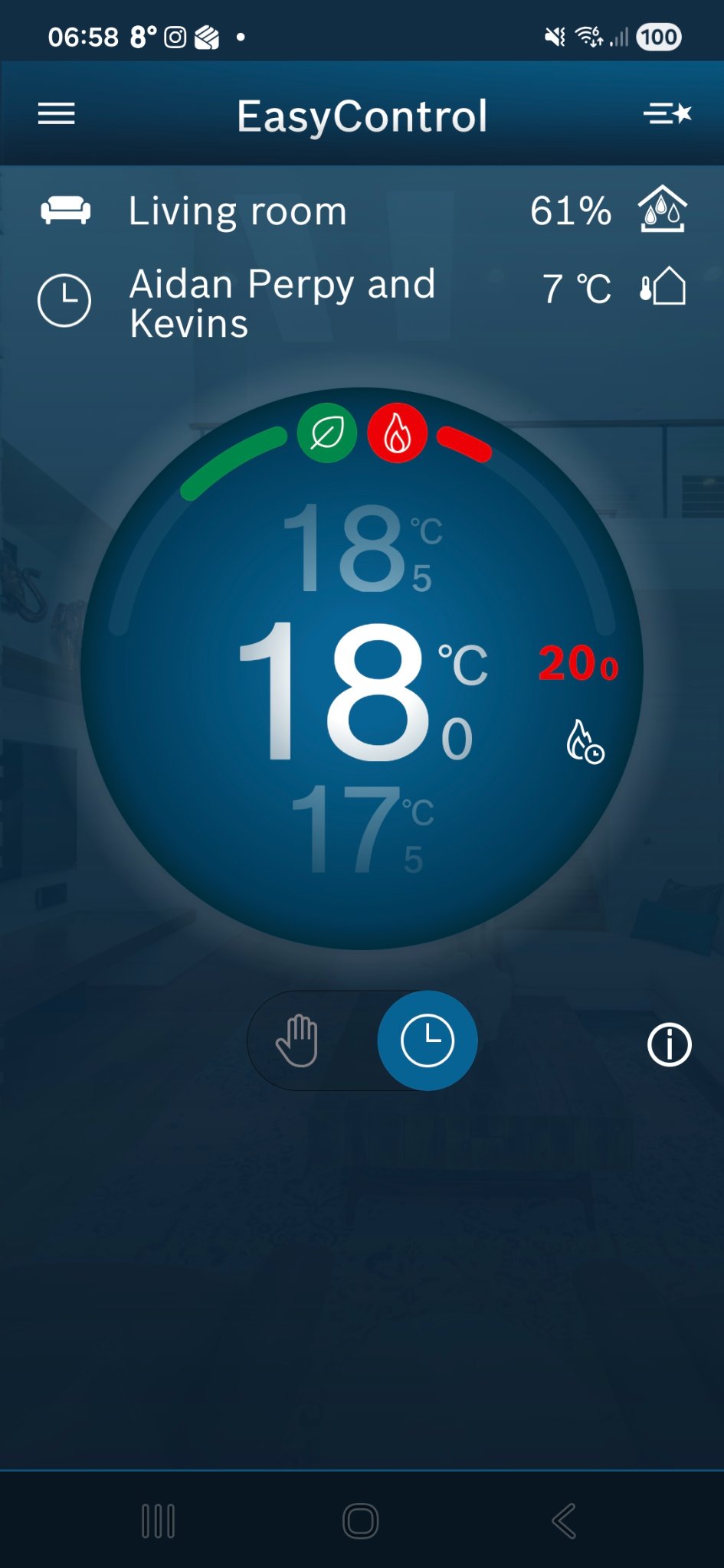

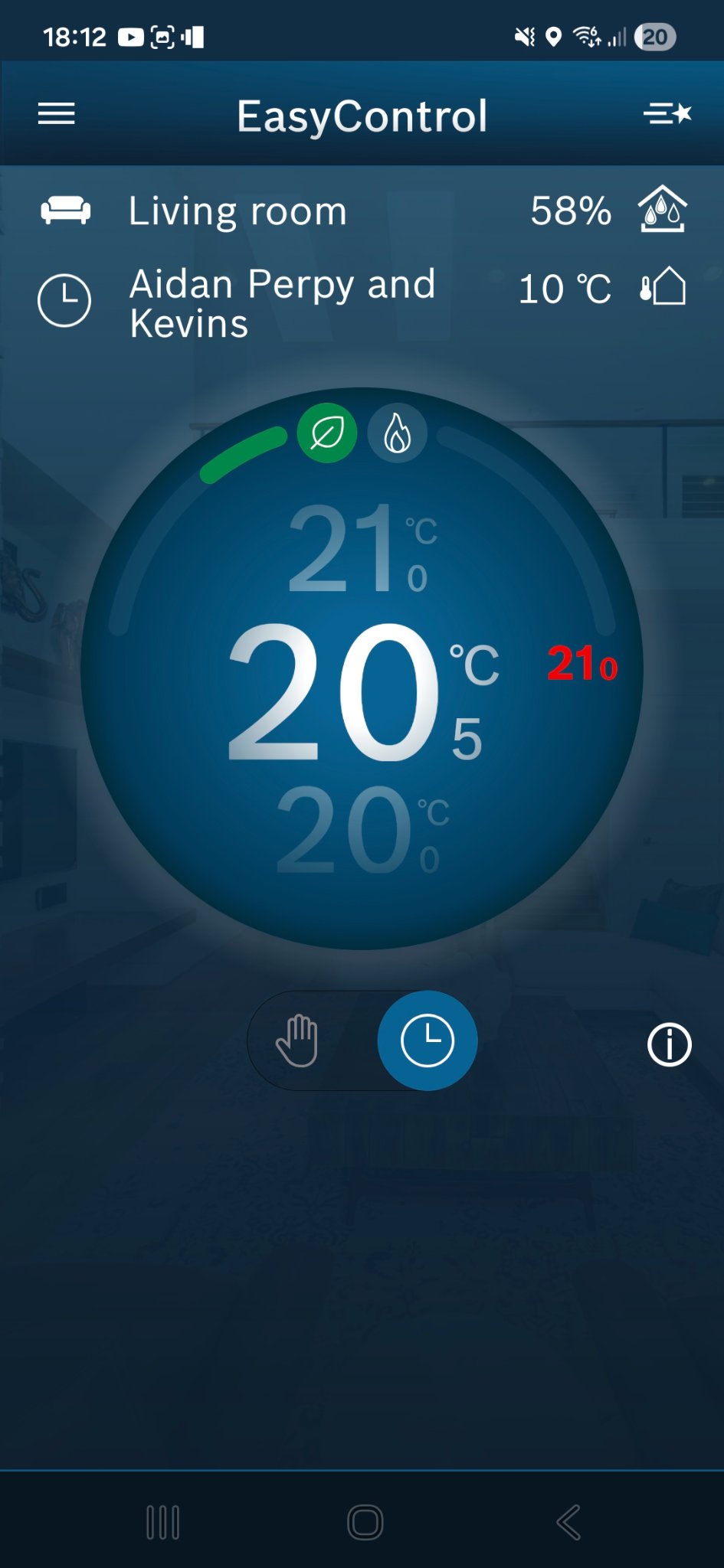

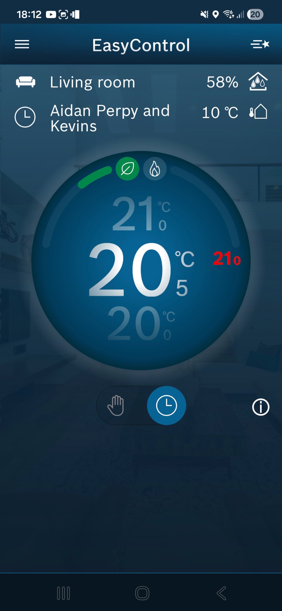

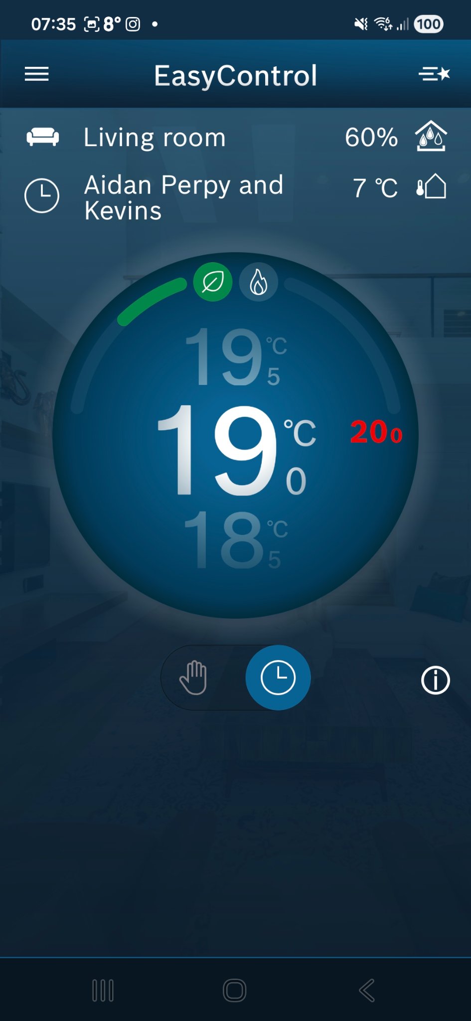

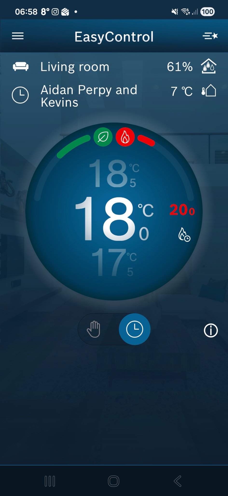

Bosch easycontrol ct200 smart thermostat advice please
..and did it fully heat the radiators, to a hot temperature?
You need to put your heating system through some stress, to ensure it is working as it should first, before worrying about the controls.

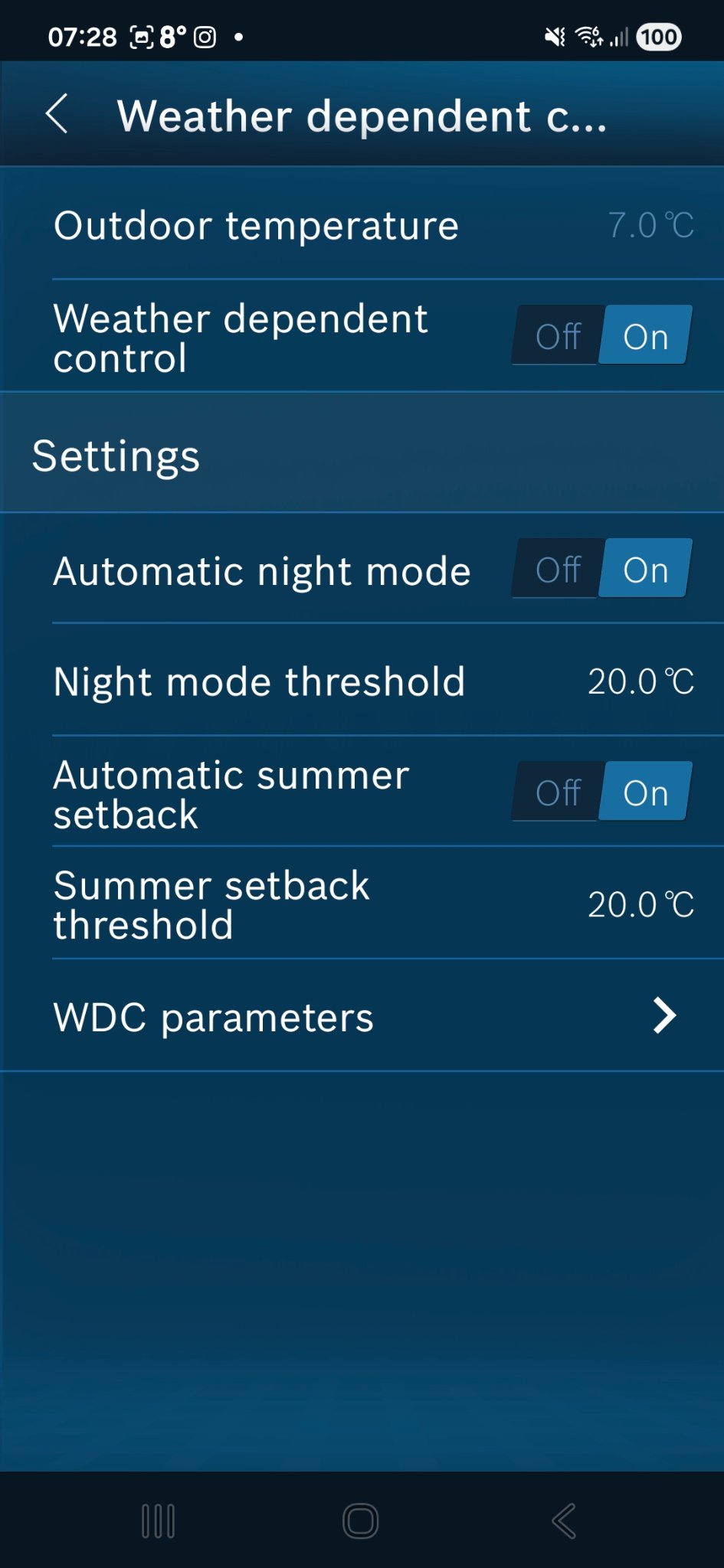

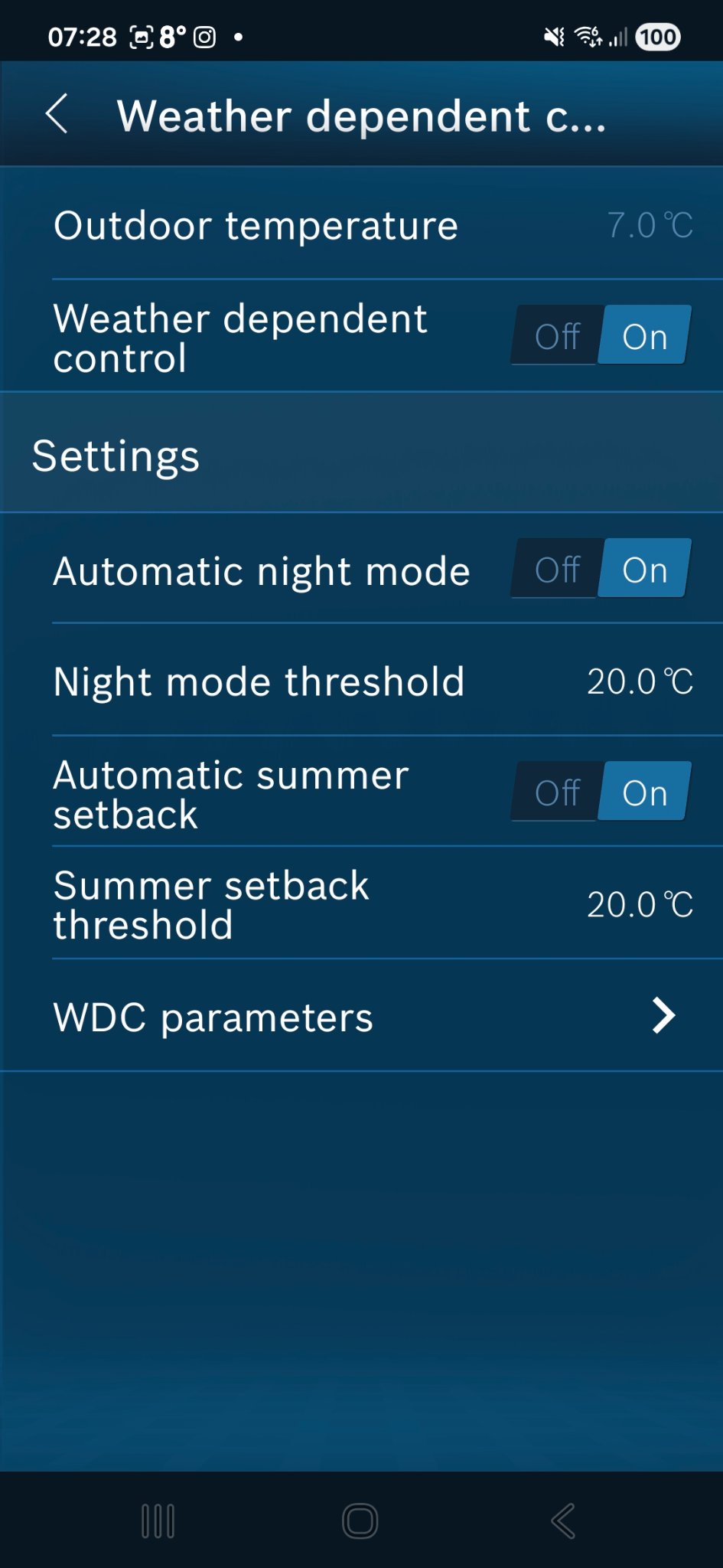

So i spoke to worchester bosch and they reckon to just leave weather compansate off. They reckon because its not to cold out and i have it turned on it is telling itself to burn low. Kinda defeats the purpose if you ask me tho. You would think it should know to burn a little bit warmer.
Bosch are probably right here — in mild weather the CT200 can undercook the system if weather compensation is active but the curve/settings aren’t really tuned yet.
Before blaming the stat itself, I’d do 3 quick checks:
  1. turn weather compensation off for 24–48 hours,
  2. set a fixed flow temp around 60–65C and see if it actually reaches target on schedule,
  3. turn the room target right up once and confirm all radiators get properly hot and the TRVs aren’t throttling things.
If it behaves normally with fixed flow / weather comp off, then the boiler and controls are basically fine — it’s the compensation setup, not a faulty thermostat. If it still crawls, I’d be looking at balancing / pump speed / control wiring next.

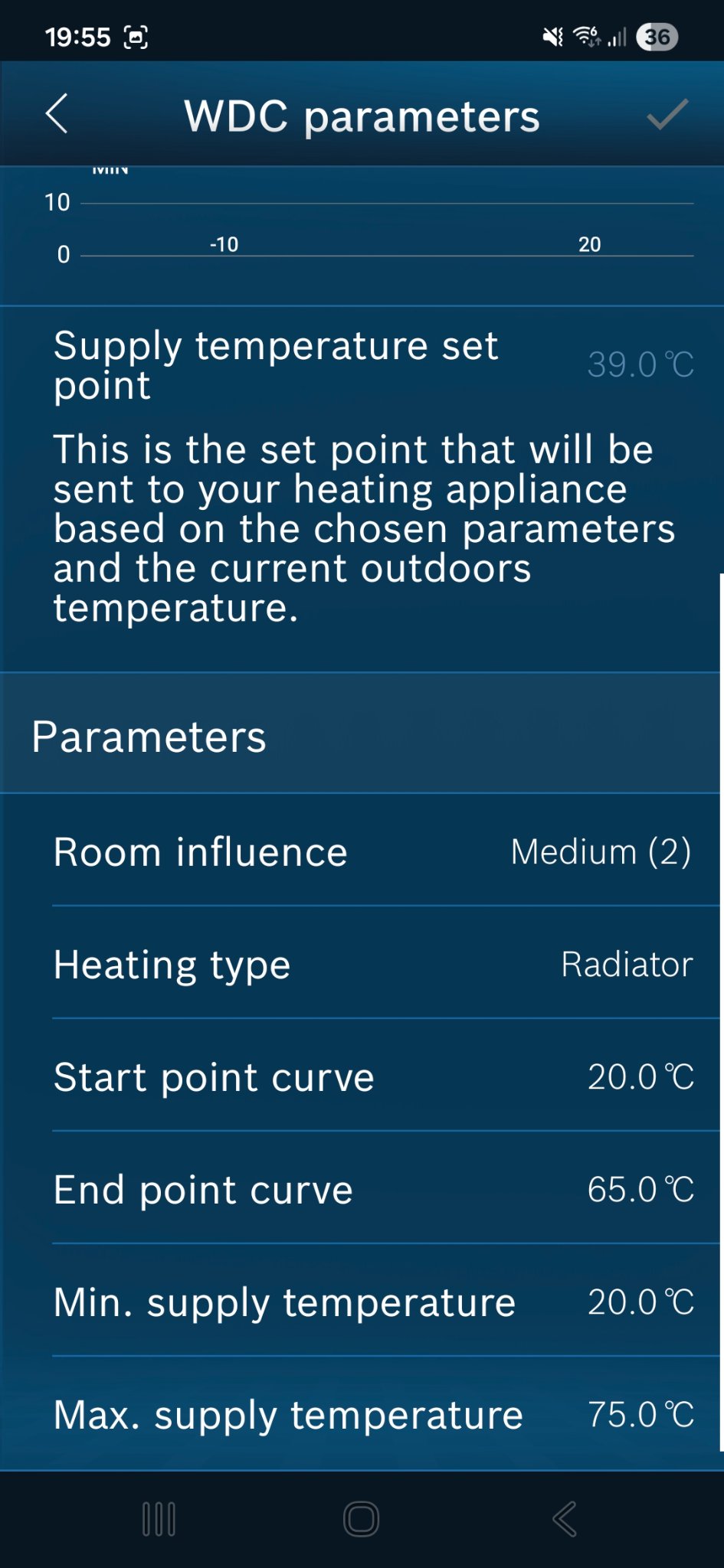

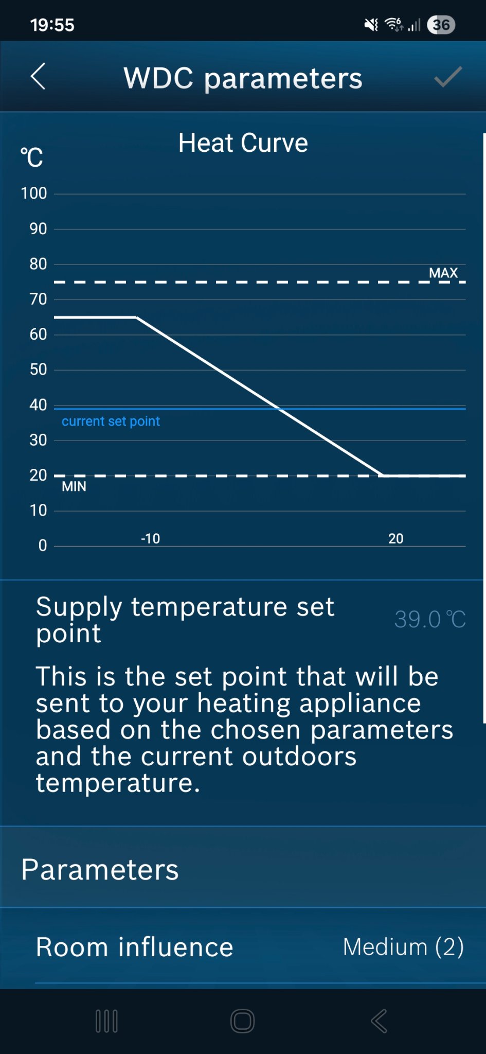

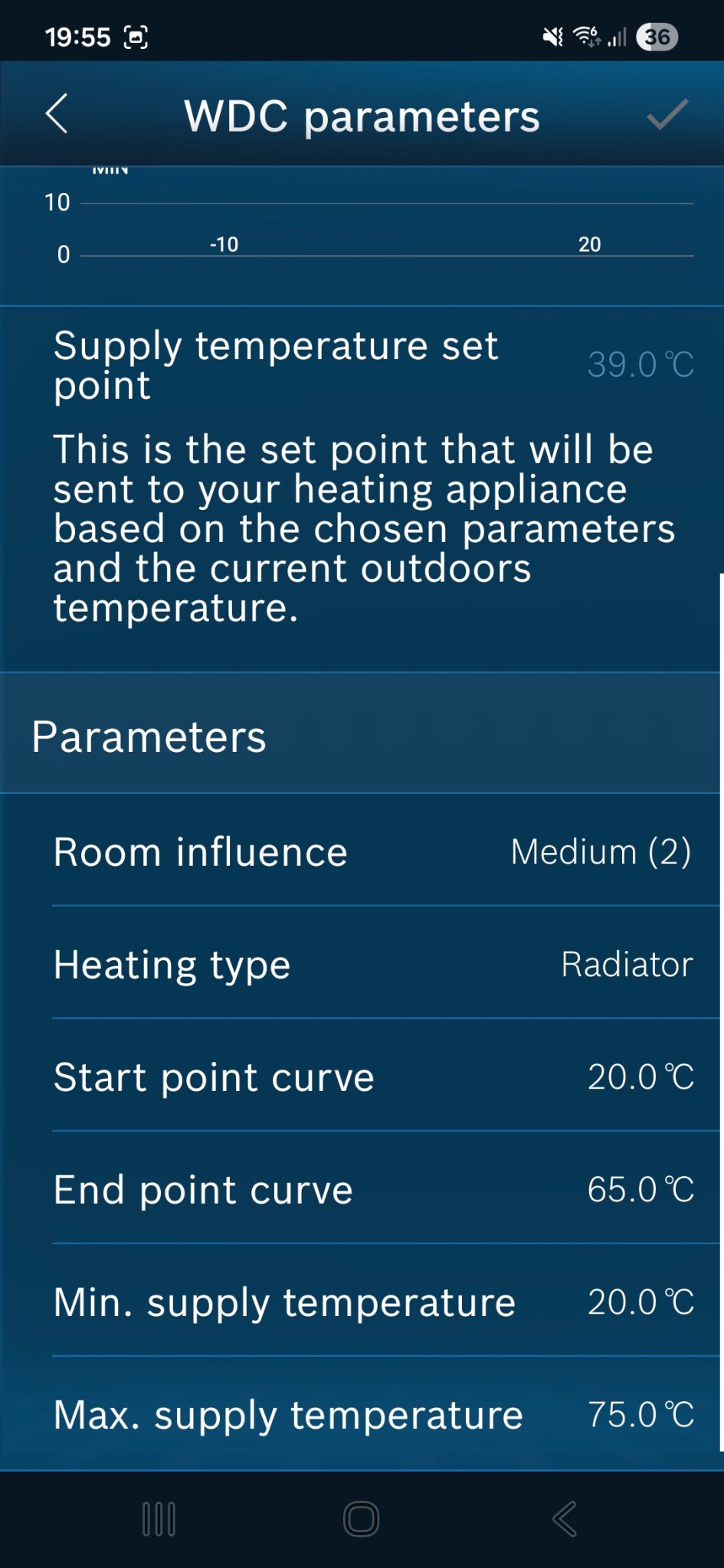

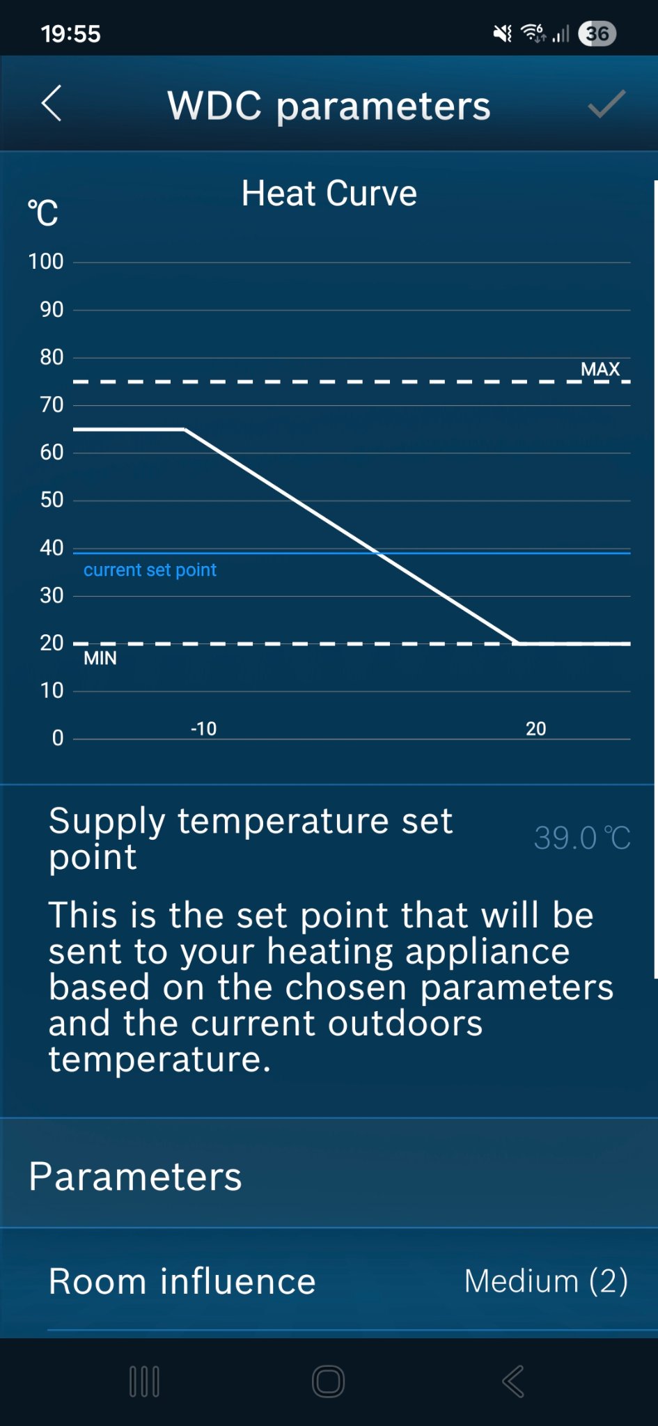

I got it running correctly. Turned the boiler up to 75 but set my heat curve to 65 so although boiler is at 75 the heat curve does the work
