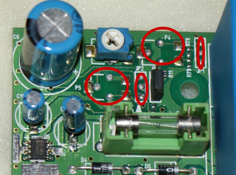

My C&M Britony SE80 had a no flame detected fault (70 , 80) so replaced PCB and all was well and fired up fine but....... showed fault 70 (overheating).
Also noticed the burners fluctuated between high and low though burner pressure was checked fine at 11mbar (yes by RGI). Flushed system with X800 which is still in and awaiting RGI returning on Friday.
The original PCB had one pot (P3) and one jumper (JP3) replacement PCB (partno 61308723) has three pots (P3, P4 and P5) and two jumpers (JP1, JP2) in the top left (as board is mounted in boiler) circled on picture.
Does anyone know what these pots and settings are for? would they affect fluctuating burners?
Finally... what should the thermistor resistance be.
many thanks in advance
The latest PCB for this is now 60000571, replacing 61308723 and 1302265.
The new version seems to serve a few different models of Chaff boilers, since its got jumpers for different settings depending on the boiler.
JP1: CF/FF (FF default)
JP2: MOD/TPR (MOD default)
JP3: 3/3 or 1/3 (3/3 default)
JP4: ATAC/CALYDRA (ATAC default)
JP5: ATAC/TIG (ATAC default)
There are also some pcb-mounted pots for adjusting power for full modulation (as well as the TAC control which was there before).
For my SE100 I changed JP2 to TPR, the others were left as default.
TPR corresponds to the 3 gas valves (and 3-level modulation) in the Britony SE100. The other option is for models fully modulating valves - not the 2002 vintage Britony SE boilers I've had the joy of owning (SE80 at previous house, SE100 at the current one).

Thanks to boilerbeasty for this post (albeit a while ago) just need the pot settings for P4 and P5.
Those are gas settings pots and we dont give advice on gas matters to DIYers.
However, I suspect that they may not be used with your boiler as it step modulates.

The replacement Board was supplied without any datasheet and the RGI is back tomorrow and we're both hoping the powerflush will have resolved the overheating.
He pointed out the modulation issue and as there was no datasheet, was unable to make any adjustments. Hence my post looking for information.
I can understand the policy of not helping in gas matters, but as you know, I can buy a PCB from just about any supplier without any Gas competence and in it should have been the datasheet- on this occasion it was ommited and as this is an older (6 years) boiler his knowledge is limited and Ariston can't help.
It appears Ariston do not support C&M to any great extent and are unable to supply individual datasheets. I am unable to return the board or get a replacement (for the datasheet) in time for the return visit.
Do you know what P4 and P5 refer to? I'm doing the legwork so he doesn't have to!

Whilst you may expect a datasheet, the pCB probably comes without one.
You may think it sounds unhelpful not to give advice to DIYers. However there is a closed section of this site where any RGI can join and ask for gas related advice.
If your RGI is a luddite without internet knowledge then so be it! But the facility is there.

I also expect a datasheet but apart from Suprima and Biasi only a few do include them.
One of the problems is that some of these pcbs are used in several boilers and the RGI is expected to have a manual for the boiler available to him.

to be fair agile these boards definetly come with a data sheet. even with pictures of either a calli or plate heat ex. to the various gas valves.. regards ariston tech, depends who you get. get your rgi to try again. theres usually an old sounding, very northern lanc/yorkshire accent guy. that really knows his stuff.

His Ipad had no signal onsite and so couldn't download any manuals! I downloaded the Britony SE manuals etc for him from chaffoteaux website but the documentation only has settings for the original PCB (single pot, single jumper).
Quite rightly he wasn't in a position to guess with the pots and jumpers without instructions.
