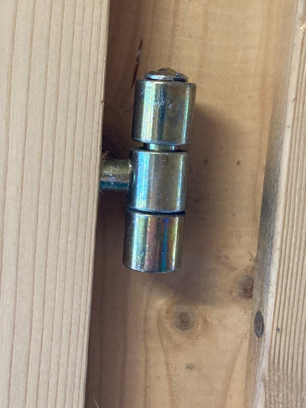

Hi
Can anyone tell me what type of hinge this is? It belongs on a door to a summer house and I need to take the door off and plane it as its not closing fully. Think I need to prise the top ring off with a small flathead screw driver and then lift off? However not sure. Any help gratefully received
pin hinge. throw it away and buy some proper hinges.
they usually just lift off
From memory, yeah, you just tap the pin out. Consider using a sacrificial screwdriver or a nail punch to whack it up from the underside.
