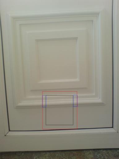

I need to fit a cat flap. I initially planned to put it through our upvc rear door, but this has a raised square 'embossed' pattern on it. I'd have to cut through this, and have been told by numerous windows / door ppl that I would not be able to weather proof it afterwards. I cannot afford to replace the panel in the door, so I am now considering going through the wall. I am fortunate in that we have a small extension at the back of the house that contains a 2nd toilet, and the wall is only single brick thickness. I decided that putting a hole through that would be the simpler, and cheaper option. What I am not clear on is how to attach the flap to the wall. I have read in a number of threads that ppl construct a tunnel using plywood.

I've just read that I might be able to use foam filler to 'pack out' the door instead. Below is a picture of the door
The black square is (roughly) the hole required for the tunnel. The red square is the outline of the cat flap frame, so I'd have to remove the raised parts as shown by the blue boxes. Could I fill them with foam filler, trim it off and let it set, then attach and silicone seal the flap ?
It will be a nightmare fitting the catflap to your door.
The best option, as you have said, is through the single brick wall.
Make your hole, screw the catflap to the brickwork, it will be made to do this, some catflaps come with their own tunnel.
Yeah, having given the door another look the raised pattern is deeper than the frame of the flap, so it'd be messy. Not to say difficult to cut. My next door neighbour has just told me that the extension is not particularly well bedded either, and removing bricks may be problematic :( I've just moved into this house, so the extension was not my doing ...
Yet another option is to remove the upvc panel and replace it with suitable ply, painted etc. Not sure how that would look though.
