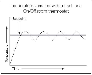

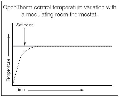

Again my old oil boiler simply turns on/off, so I always get a hysteresis, modern boilers with analogue control can avoid this. Temp_variation_on_off.jpgTemp_variation_OpenTherm.jpg As shown, again in theory no room can overheat, as the TRV will stop it, and the wall thermostat is there to stop the room being cold, but in real terms not that simple, in the summer I love a room at 17ºC, but in winter want 20ºC. I would only turn on the AC at 24ºC, but would not want 24ºC in the winter. The AC is easy, if I need it there is loads of sun, so the solar panels are making more power than they use, and even without the AC no real worry, we have too many power cuts to consider an electric powered central heating, the sun and batteries may keep the pumps and boiler running, but not enough to heat the house. So waiting for a year when no power cuts over 6 hours reported before considering heat pumps.
