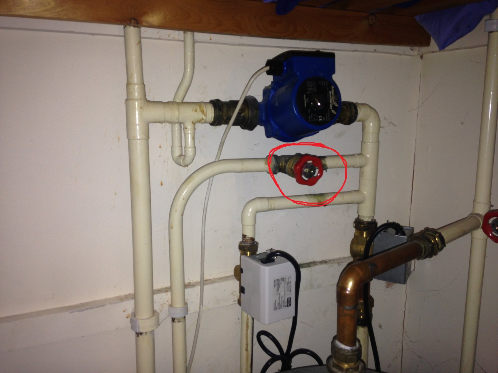

Is the pump wired direct to boiler rather than the wiring centre? If not it should be.
Also, is there an automatic bypass valve on the flow pipe from boiler before the 2 port valves, and pipes back into return pipe to boiler?
If not, pump and fan will stay in for ages as boiler can't get rid of heat from heat exchanger after a demand.
This will shorten lifespan of boiler if not fitted

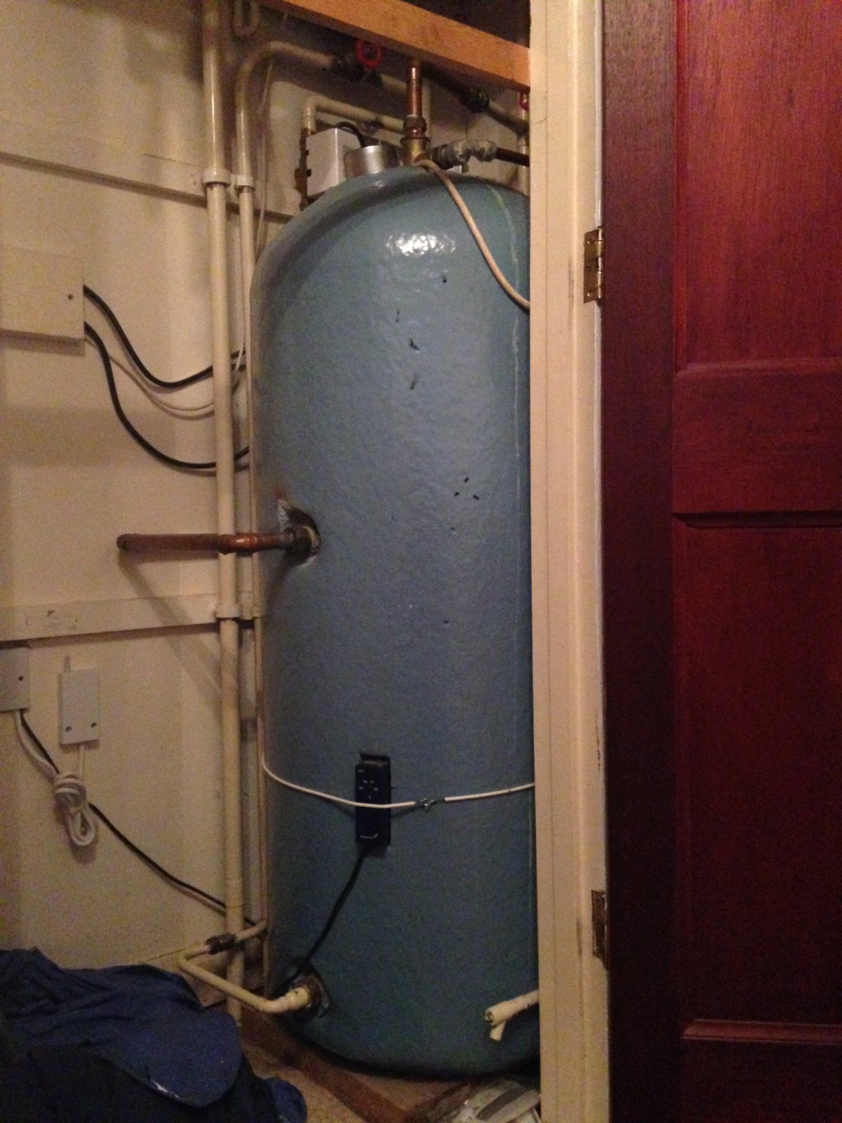

McCombi, im hoping you may have suggested the solution, after looking at my pipework I think I do have a bypass pipe back to the boiler from the pump which has a tap on it (marked with a red circle on pic 2), this tap is currently closed allowing nothing to flow back, do you think this should be open?
Hopefully the images below will show the pipework in my airing cupboard ok, the close up is of the pipework at the top of the main image, i assume the larger diameter pipe coming up through the floorboards is the supply from the boiler and the smaller diameter one next to it is the return supply to the boiler for the bypass.
Yes crack it open slightly. It should help to take residual heat away from boiler
Ahoukd be an automatic bypass type but a gate valve is better than nothing
Thanks McCombi, seems to have sorted it, earlier in this evening it took 20 mins for the pump to stop running after i turned off the HW timer and just tried it again now whilst it was calling for HW and the pump only overran for 3 mins and switched off.
