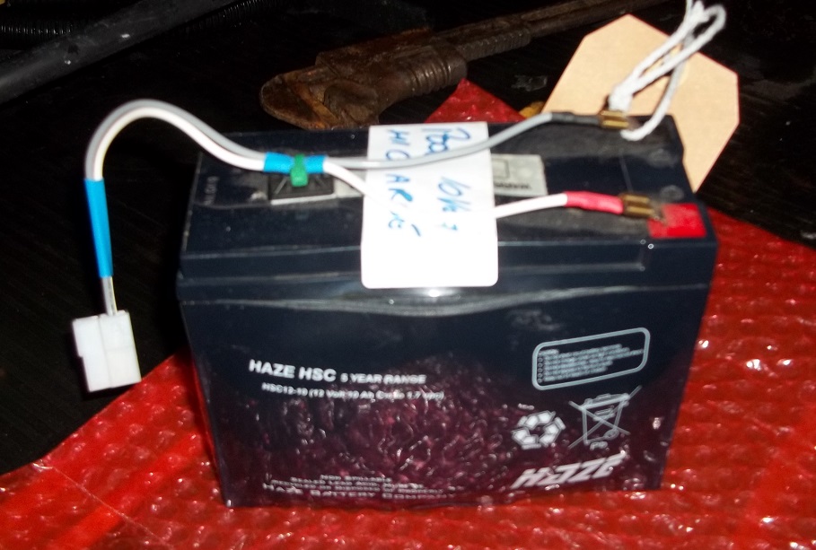

Attempts to recover a 12 volts 7 Ah sealed lead acid battery were going well. It had been deeply dis-charged to about 6 volts but had seemed to recover after several days of tender loving care with a terminal voltage of about 13 volts
This evening it was taking about 20 mA on from a constant voltage recharger at 13.8 volts and had been for over a day.
Then in the space of a few minutes it become very hot and the sides were swelling out.
As it was taking less than 50 mA at the ime I assume one of the cells has gone short ciruit and discharged itself.
Motto. Never leave a suspect lead acid battery un-attended while it is be re-charged / recovered.

Did you expect, or have reasonable grounds to hope, that it could ever be brought back to a useful level of performance, not only taking a reasonable charge, but holding it for a useful amount of time?

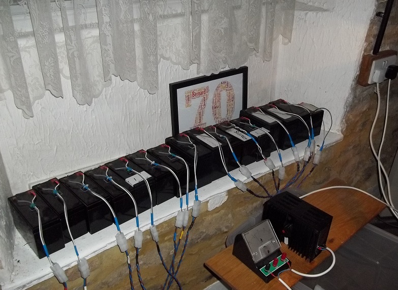

That said I am keeping a close eye on the other batteries to be used for lighting at the village Christmas Fayre
Short answer is No,
Long answer is that I had hoped it could be recovered as it had, after a short period of tender loving care, provided two amp hours of supply ( 250mA for 8 hours ).
Sitting outside and covered in frost it is showing 11.5 V but this drops to 3.5 V when pulling 100 mA so it is a total loss.

The 7 Ah you have it seems they don't last long, theroy a VRLA should have a long life,
The other batteries have given good service and are still in good condition. This failure was due to the battery being left connected to an incandesent lamp for several days by the (ex) friend I lent it to for lighting an Emergency Exit Sign. He didn't disconnect it.
In fact it is powering a short strip of LED tape lighting a sign as I type. Run it down before taking it to the recycling depot
