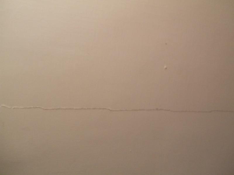

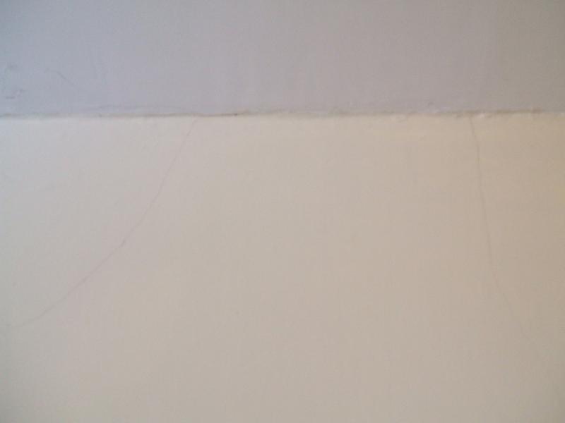

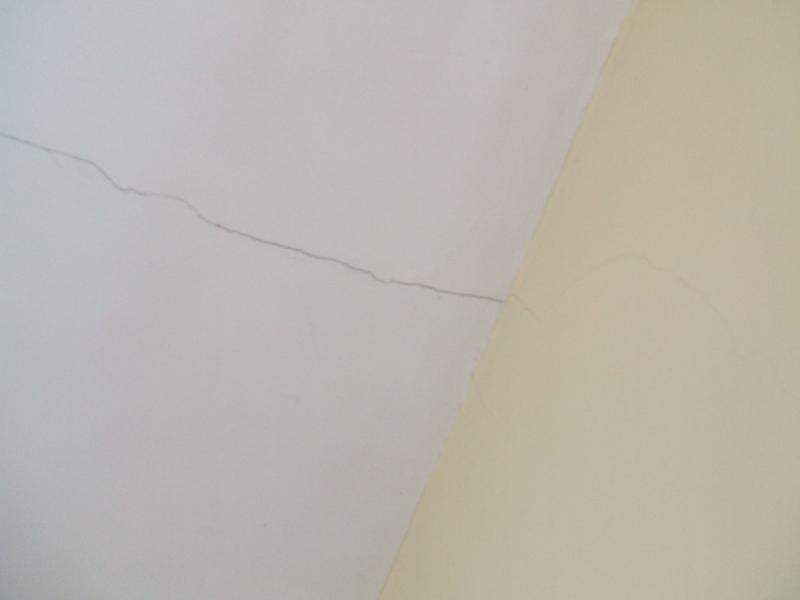

The house is about 50 years old I've lived here for 11 years, over the last year there seem to be more and more cracks appearing in the ceilings and walls.

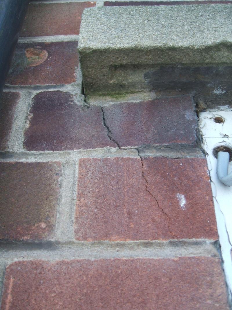

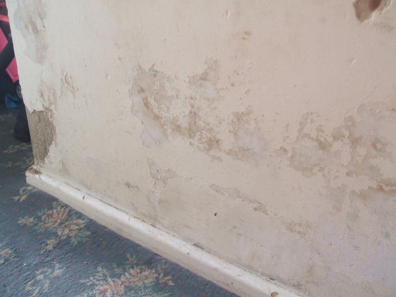

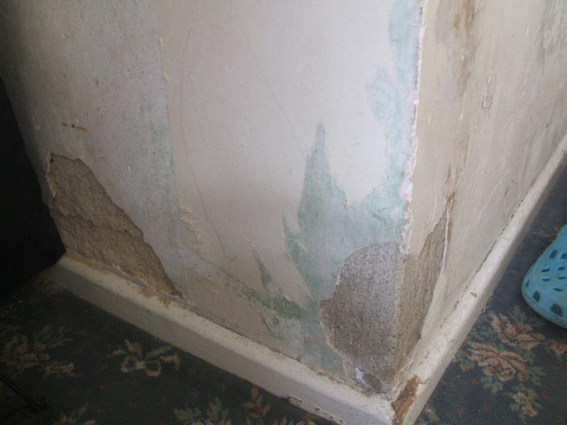

There was a bit of water damage from the bathroom that went through to the kitchen and where that's been the paint keeps peeling off the wall. There is a damp internal wall where no body seems to know where the damp is coming from so the plaster there is just crumbling away. There is a crack through two bricks to the top of one of the windows but a builder I had to look at it said don't worry about it unless the glass in the window cracks!
Can someone please give me some advice as to what the problems/problem could be please as I'm loosing confidence with builders and I don't want to feel like I'm living in a house that's falling to pieces around me.
Thank you in advance

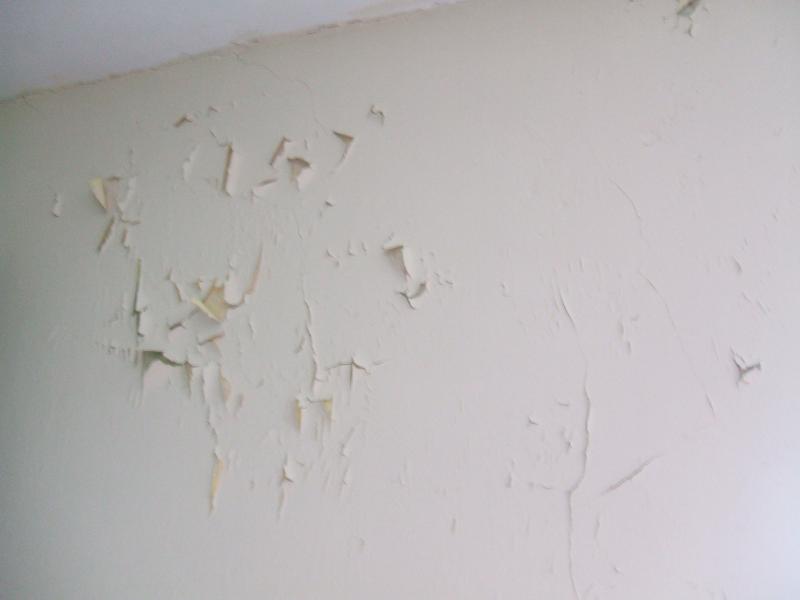

would you like to post some pictures for us to have a look at? the paint thats peeling? has the wall completley dried ? it could be moisture pushing the paint off, its best to take some pics of all your probs and post them.
It should be dry, it was nearly 2 years ago and it was repainted about 8 months after it happened. Will post some pictures, if I can figure out how to do it in a little while.

the peeling paint looks like its been painted onto a shiny surface with no key and condensation may be helping to lift it off, the damp at the bottom of the walls could be rising damp and could be treated with dryzone cream (injected through holes after remonving old plaster, as for the cracks above the window i dont think thats nothing to worry about, as for the cracks on the boards looks like they need cutting back renforced with screws then filled taped and easyfilled, thats just my thoughts, some of the others may be along later and give their views

i would scrape all that back then use a primer sealer or use a matt emulsion befor the final coat
