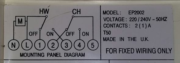

Hi,
I'm after a bit of help to narrow down a fault. Our boiler is not firing up all the time even when programmer is on and hall based thermostat is set way above actual temp. It has been intermittent and if I turn off and then on at the programmer it will often come on. Today that wouldn't work either. Switching heating on fires up the boiler with no issues. When I then switched heating off and then tried the CH that fired up the boiler too.
Reading so far seems to suggest that this could be a sticking relay in the programmer. I'm leaning to replacing the EP2002 with an EP2 which is a straight swap on the existing backplate. We are planning to move house this year so not worth swapping to more sophisticated solutions.
I'd just like to be able to be sure it's the programmer before spending £80 on one. Any tips? I am capable of using a multimeter and working safely. I haven't had the programmer face off yet, but imagine that I could check output of CH relay assuming it's fairly obvious where that is when get the face off.
Thanks very much,
Stuart
