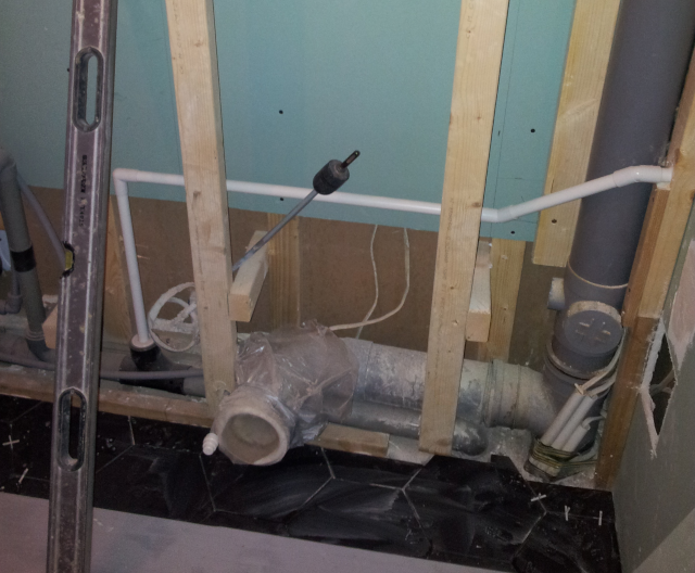

The overflow of a small overhead pressure tank is being fed into this device. My concern is that the open vented device will let in smell and evaporated waste water. It might even cause a flood if there is a blockage somewhere. Am I scaring myself silly for no reason? Thanks.
1. The device is what is known as a tun dish. Its purpose is to let you know if there is water running through it (there shouldn't be) and to provide an air inlet to prevent an air lock / syphon forming.
2. Whether or not it will let smells in depends on where / how it is terminated:
3a. If into a soil stack, it could let smells in. Given that it is the vent for an expansion vessel, there should be no trap further in the system to prevent smells coming back.
3b. If it just vents to outside, no smells to come back.
4. If there is a blockage below the tun dish, water could come back and overflow the top of it. However, given that there should never be any water in it, this is unlikely but not 100% impossible.

The small overhead tank is used for providing pressure to the hot water tank sitting on the ground level. The the top of the immersion heater for the hot water tank is about the level of the water valves you see in the photo, or slightly higher.
The white pipe feeds in to a waste pipe that the basin waste feeds into. The two feeds are separate. The white pipe is closer to the point where waste waster is drained out of the flat below the concrete floor. The waste pipe is maybe half the diameter of the sewage pipe. These waste pipes are separate above ground. What is below, I have no way to tell.
See the white pipe here:

Anyway, should I delete the tundish? That white pipe is vented into the cistern anyway. Don't see why it would need another vent with the tundish. I think I got some idiot builders doing stupid things.

The tundish is there to show when there is an issue with the cistern and when it overflows. It's a requirement when any overflow isn't externally visible. You can get one way sealed tundishes (Tun5 - CL) that perform the same function but a) are clear see thru and b) have a one way valve that seals up the pipe run to stop smells.

I have already asked the builder to change the tundish. If he wants labour for it, then I'll do it myself.
