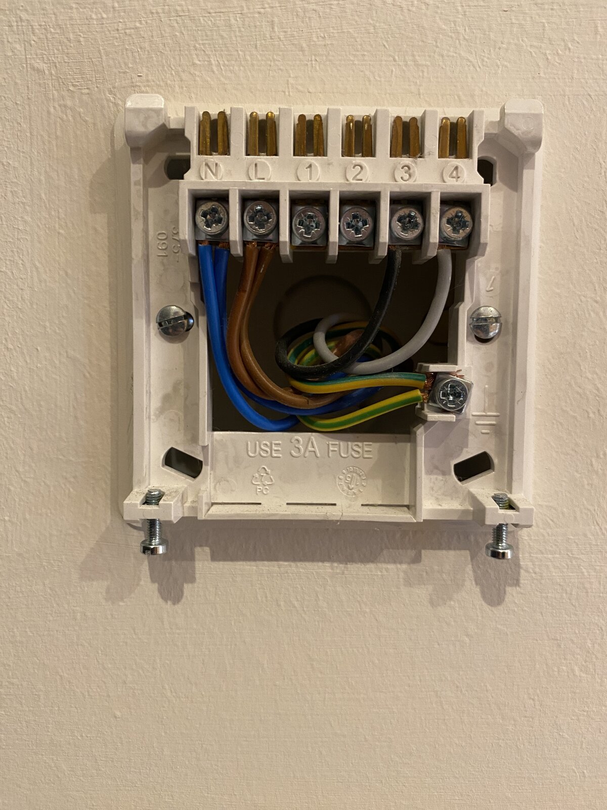

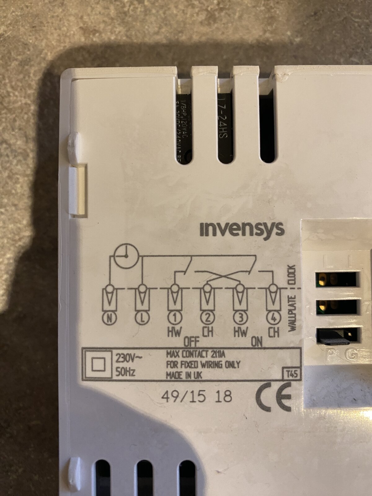

Hi all, apologies another how do I wire up a nest thread.
I was hoping someone could confirm if I'm on the right track or not, looking to replace my Drayton LP522 with a Nest.
The Drayton is wired up as follows:
After doing some reading, I thought this would be correct for the Nest:
2 Neutral wires from N to N
2 Live wires from L to L
2 Earth wires to Earth
Drayton 3 to Nest 6
Drayton 4 to Nest 3
Link wire from L to 2
Link wire from L to 5
Thanks in advance
You’ll also need to power the Nest from a usb or run new wiring to use T1 and T2.
Thanks guys, there isn't currently a thermostat fitted for some bizarre reason, I'd have expected there to be one in a 5 year old property!
I am looking to run the Nest thermostat from a remote location, so wouldn't be hard wiring.
Cheers
