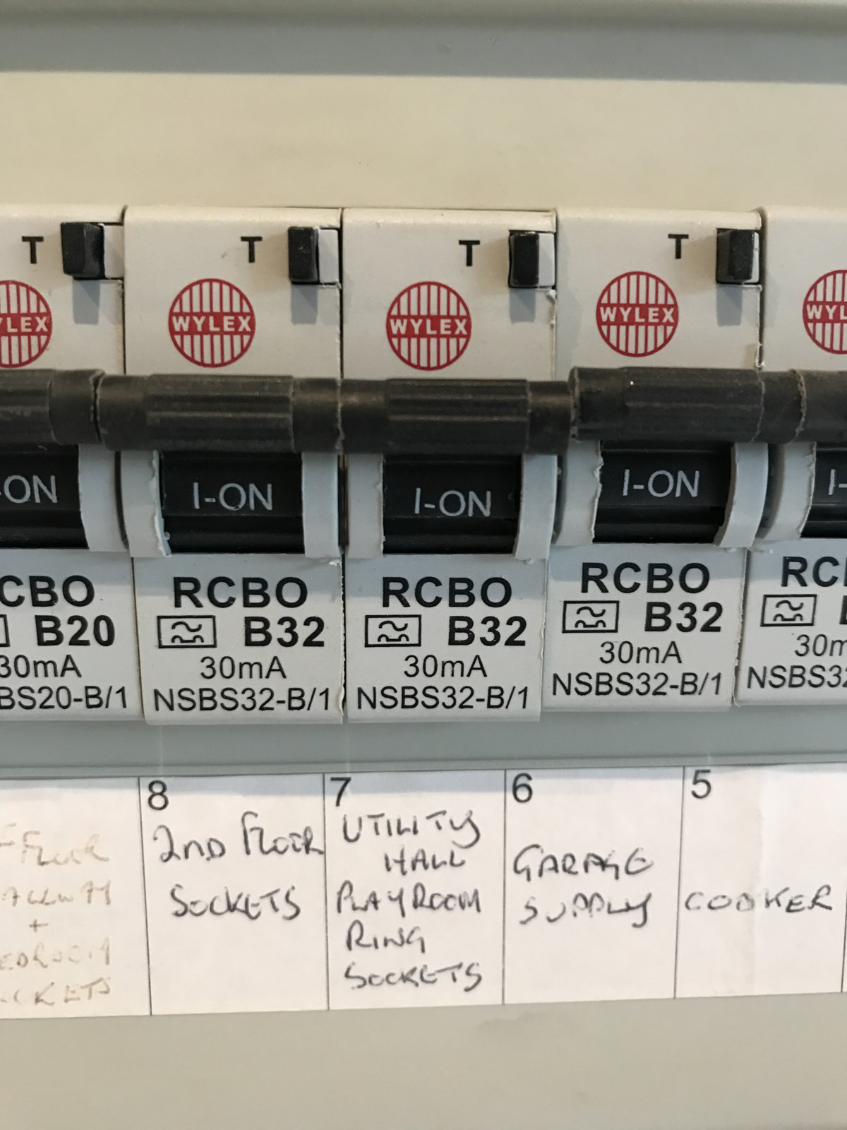

The 1st circuit is on a RCBO B32 (Wylex) and the cooker / microwave ones are marked as NB1-63 B16 (CH(i)NT). They're the only boxes I can see. 20180531_060307403_iOS.jpg 20180531_060229475_iOS.jpg
As for the first problem, which tripped the RCBO, with some such devices one has to push the lever firmly down (into the 'off' position) before it will reset properly when pushed back up (into the 'on' position). Did you try that?

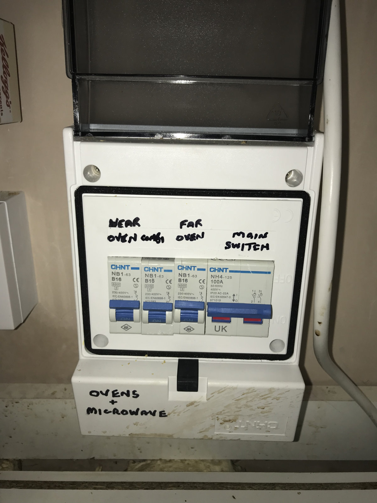

Do you know where that small CU for cooker/microwave gets its power from? I see that your main CU has an RCBO labelled 'cooker' - what does that do?

OK. What about the cooker/microwave CU - do you know where it is fed from? The main mystery, of course, is why two (or more) seemingly totally unrelated things are seemingly misbehaving simultaneously. That CU has three MCBs, labelled 'Near oven", "combi" (I presume the microwave) and "Far oven" - are all three of those appliances now not working? If so, then one can but presume that that CU is not getting electricity from whatever is meant to be feeding it.

That's correct, John - there's a main oven, a combi oven / microwave and a steamer oven that those three MCBs cover. All three appliances are devoid of electric.
In terms of where that CU is getting power, I don't know to be honest. Would you expect there to be a connection to the main board or is that not how it's normally set up?
That's what I thought. Since it is essentially inconceivable that all three circuits, all three MCBs or all three appliances will have become faulty simultaneously, one has to assume that electricity is not getting as far as those MCBs, and maybe not as far as that mini CU.

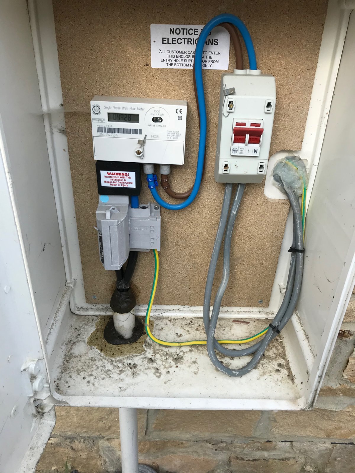

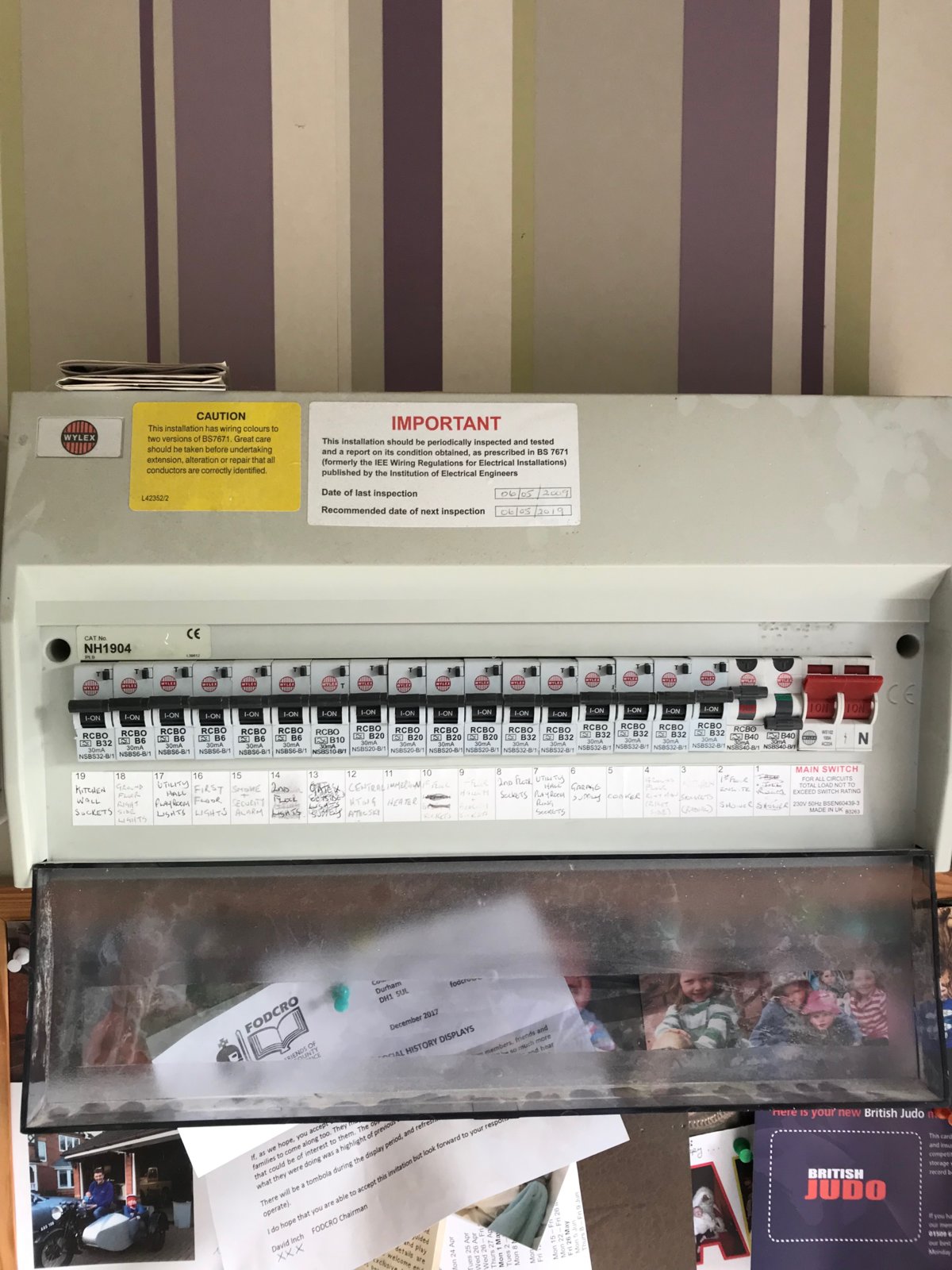

It might possibly come from the main board, but it probably more likely that the supply from your meter splits to feed the main and 'mini' CUs. Could you perhaps provide a photo(s) showing both of the CUs, the meter, incoming supply to your house etc. and what can be seen of cables between them?
Thanks. Where is the ovens/microwave mini CU - in the kitchen? Are the main 'feed" cables going to the main CU and/or that mini one visible and, if so, could we have wider photos which show them as well as the CUs themselves.
What is the labelling of the right-most one of the RCBOs (the B40, next to main switch - which was 'off' when you took the photo)?

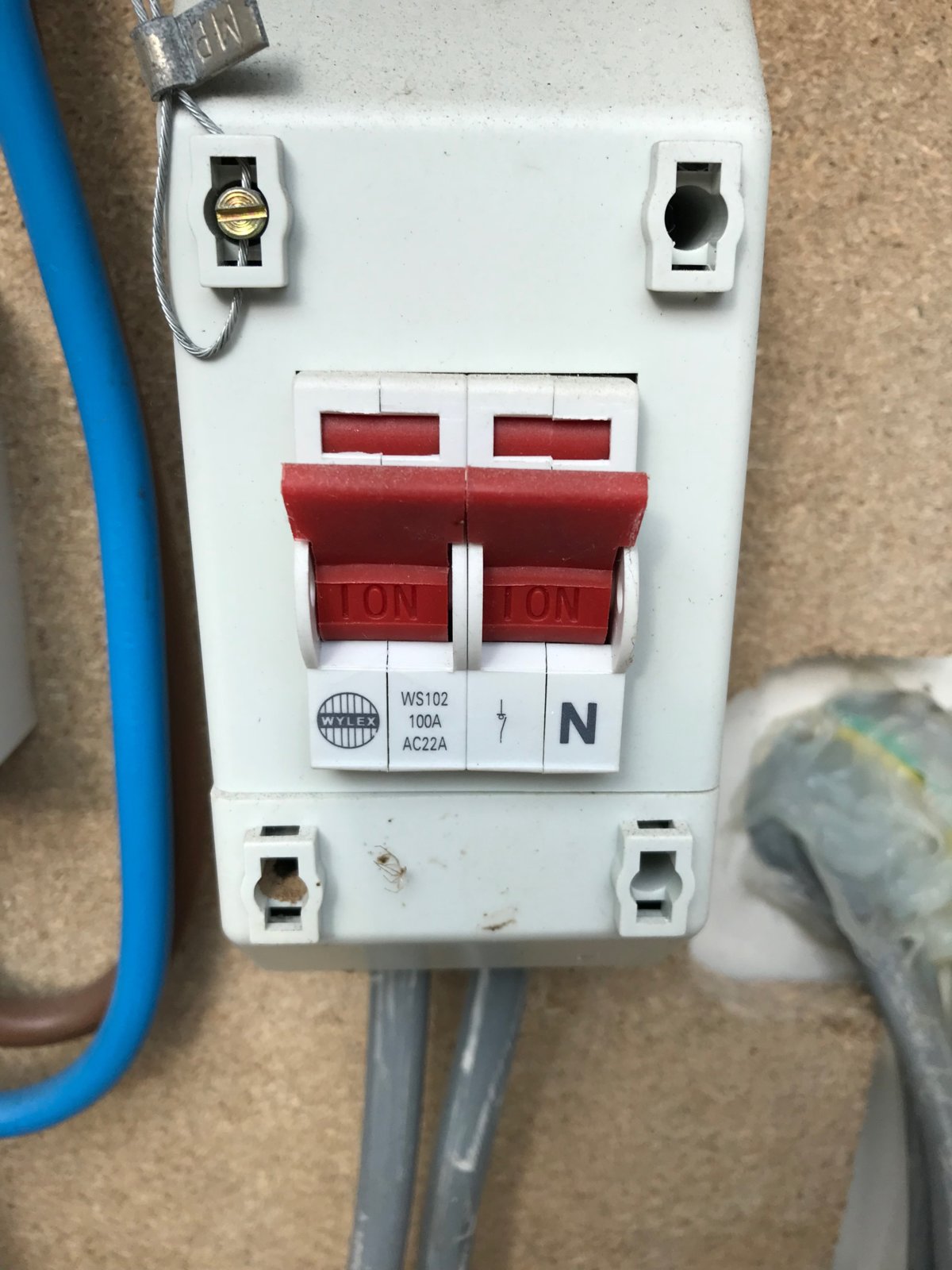

(1) oven / microwave mini CU is in the kitchen in a cupboard under one of the ovens. The location is to the right of the outside meter cupboard as you look at the image
(2) no no cables are visible. The main CU is directly behind the outside meter cupboard, so I assume the two cables from the meter that go into our wall are to the main and mini CUs?
(3) the off RCBO is just for an ensuite shower that hasn't been installed. This has always been off.
That's not "two cables" in the sense you presumably mean - it's just one pair of single-core cables (one Live/Line and the other Neutral). They presumably must 'split' somewhere, into 'two pairs', with one one pair going to each CU, since there seems little evidence that the mini CU is 'fed from' the main one.
Since it would appear that no power is getting to the mini CU, locating where that 'split' happens (and where the cables go) could be crucial. Particularly if the mini-CU is a significant distance from the meter cabinet, it's far from impossible that there is a fuse somewhere in the path, and that could even be your problem.
Kind Regards, John

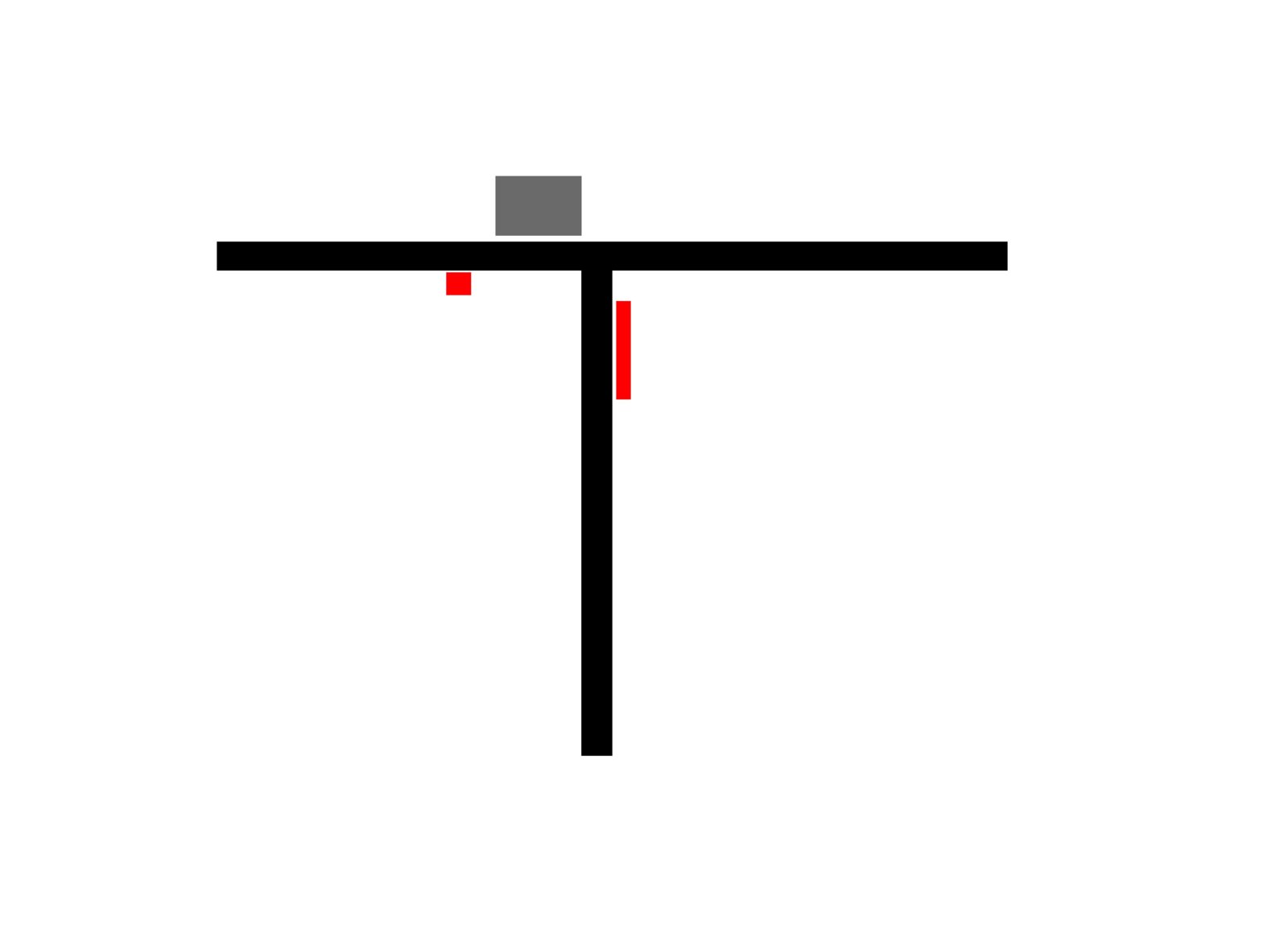

Many thanks for your continued advice, John. The mini CU is only around 6ft from the main CU. If you look at the crude diagram below, the mini CU is the small red box, the main CU the long red rectangle. Black areas are walls and the grey box is the meter box on the outside wall. There are no visible cables at all to either CU - presumably they're behind the plasterboard. The only other visible cable is a thick white one from the mini CU going vertically up, which I assume is the power cable to the oven above.
Thanks. Your diagram is clear enough, but it still doesn't answer the question (through no fault of yours!).
As I said, there is only one pair of cables coming from the isolator in the meter cupboard, but those are either splitting (into two pairs) to feed the CUs, or else the mini CU is somehow getting fed from the main one. The former seems the more likely, but it's really a bit naughty if, as seems to be the case, the 'splitting' is occurring somewhere unseen and inaccessible (presumably in some sort of junction box or other electrical accessory). I suppose it's just about possible that the 'thick white cable' you can see is part of the feed from main CU to mini one, but that is fairly unlikely.
I presume that you are certain that there are no other visible 'electrical boxes'/whatever anywhere in the vicinity of either of the CUs or where the cables (presumably) come through the wall from the meter box?
