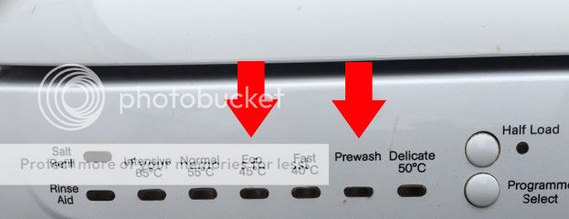

The front of my dishwasher has started to flash 2 lights at the same time.
They are as follows.
Eco45 & Prewash
Please can you advise where or what i should do to check/fix this.
Many thanks.

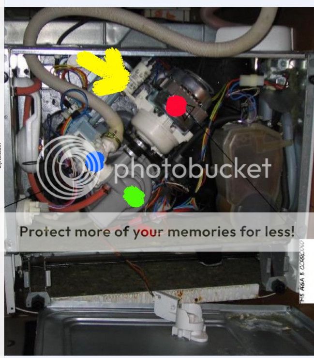

Pressure chamber blocked blow down tube.
Tip it in its side remove base and tube is on the right hand side , it's either a clear or black tube. Disconnect from pressure switch and give it a blow.
Bottom left of pic. That's the pressure switch, there's a tube going off it pointing upwards next to the orange tube.
Hi,
I removed the small grey tube as advise and blown into it but its free with no obstruction.
I just going to remove the sump "the item the the inside filter basket sits in" just to see if anything in there.
Any advise you can give me whilst i have it apart etc.
No. Don't remove the sump. Do the lights flash within 2 mins does it spray water round.
Hi,
Sorry for no reply but I never received an email saying you had replied ?
I put the item back together and worked fine every since !!
Thanks for the advice.
