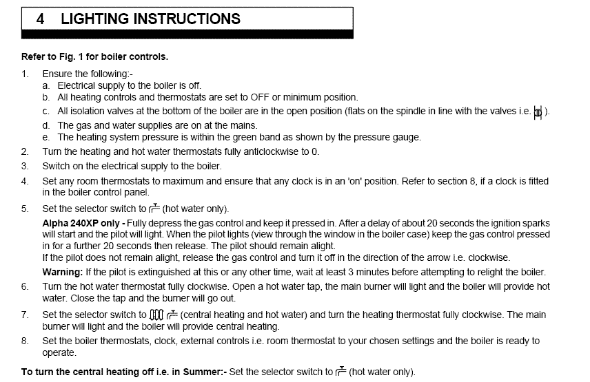

Hi
I was wondering if anyone could help me with starting back up my boiler. Having a kitchen installed in the weekend and need instructions on how to fire back up the boiler once they have finished? The last owners left no instruction manual.

XP and P the same I think.
thanks Chris
will try
I also just rung the manufacturer and they are sending me instructions via e-mail.
