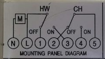

I assume that the Potterton is an EP2001, (not E2001) if so the wiring connections are:
The flomaster 3439G connections are:
So as you can see, the connections for both products are the same, with the exception that the Potterton has a terminal (5) which is linked to the live terminal. The Flomaster has this link made internally already, so doesn't need or have a terminal (5). The other terminals are exactly the same. N, L, 1, 2, 3, 4. so it should have been a fairly easy exchange.

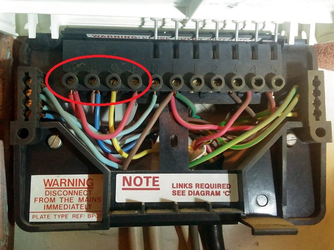

The Potterton does have additional terminals which allow it to be used as a wiring centre. Terminals A, B, C, & D are provided for the installers convenience, but do not have any functionality as far as the programmer is concerned. If they were used, any wires that were in these terminals, would need to remain connected together exactly as they are, but new connectors would be required as the Flomaster doesn't have this facility. So in the example below with these terminals highlighted, the two red wires in A need to remain connected together, as do the brown and blue in B and so on. (This is just an example, so don't try to replicate it, your wiring and colours will be different, depending on the personal preferences of the original installer)

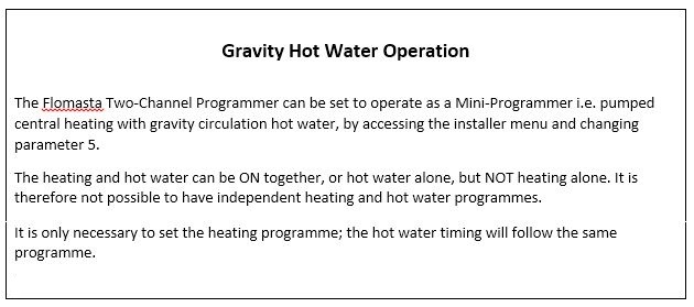

check that your new programmer is set to fully pumped and not gravity, if set to gravity you wont get CH on its own will be a slider or a jumper tag that you change
My apologies just looked at the instructions for your new programmer and the parameters are changed using the buttons on your programmer, follow the instructions and make sure it is set to fully pumped and not Gravity HW
The boiler is a 2001 vintage Ideal Classic, pumped CH and gravity HW. Serviced in the last few days and otherwise working perfectly. Does that make a difference?

As far as I can recall, he had wired N and L as shown with connections to 1 and 4 only. When he wired the pump to 1, it ran but the boiler didn’t fire. He rewired the pump to 4 so the CH would work. Should 3 and 4 be connected to something, if so what? Is it possible that there’s an internal fault on the new device?
What Ian says is absolutely correct, with the plumbing restrictions of the system you have, the new programmer should be set to gravity mode of operation. That will allow you one of two options.
1) Hot water only
2) Central heating and hot water
Selecting the hot water 'on' will cause the boiler to light and the water cylinder will be heated by gravity circulation of water between it and the boiler
Selecting the heating 'on' will only start the pump. This means that hot water also needs to be on in order to keep the boiler running.

The "spark" who installed it for you, having seen the installation should have set the new programmer to operate in gravity mode as per the instructions:
Thanks again Stem and Ianmac. The spark has been back and adjusted the wiring and the programmer has been reset as recommended. Now running as per the old Potterton kit.
