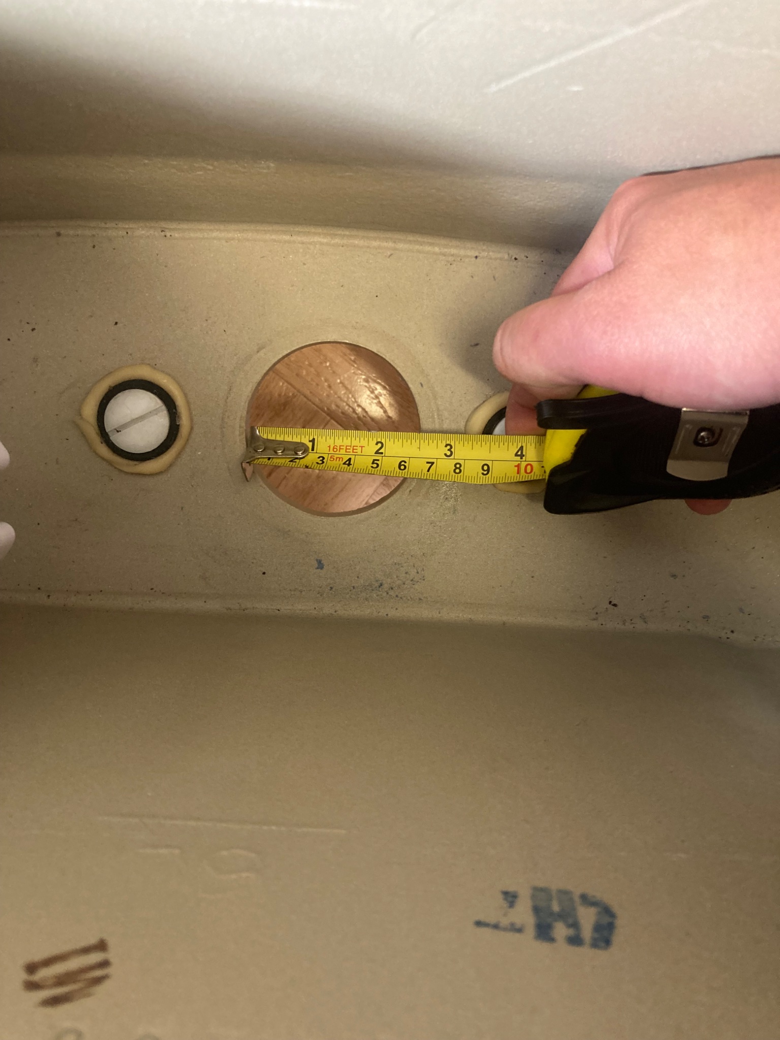

Anyone know if you can get a 21/2 inch flush valve all the ones online are 1-1.5 and 2 inch,
Unsure which one to get calling all plumbers
2 inch is what you need. This is the thread size not the diameter.
