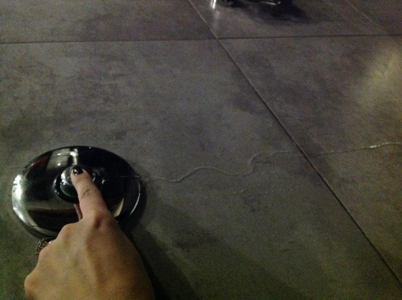

I have a flushing button in the wall, and no tank, the water comes from a reservoir I have on the roof, and according to how long I press the button it flushes. My issue is , the button in the wall is leaking water when I push it.
Behind the tile is limestone wall, on the other side of the wall is another bathroom.
The flushing button is basically a tap that only opens when pushed, unless there is an access in the other bathroom then the only answer is to remove the tile and fit a new button.
Andy
I have a new problem...I don't have extra tiles to replace. These aren't recently placed. So I won't find matching.

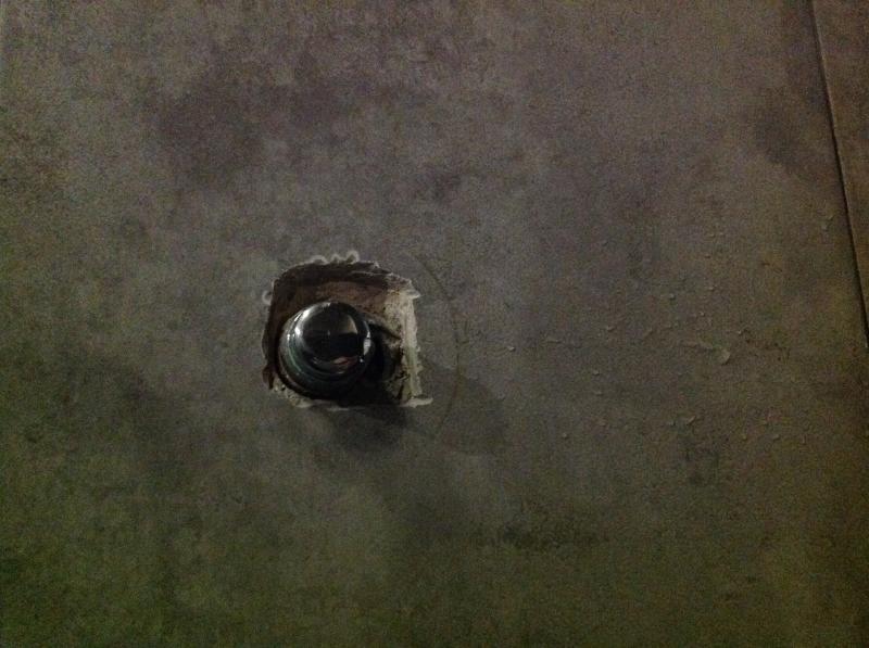

Or the button 'might' screw out and screw a new one in place, the water will have to be turned off first and drained down.
Andy
Tried unscrewing the button, it doesn't unscrew. I guess I will just have to go around hoping to match the tile.
You may be better to get a plumber from your local area who understands how these cisterns work.
