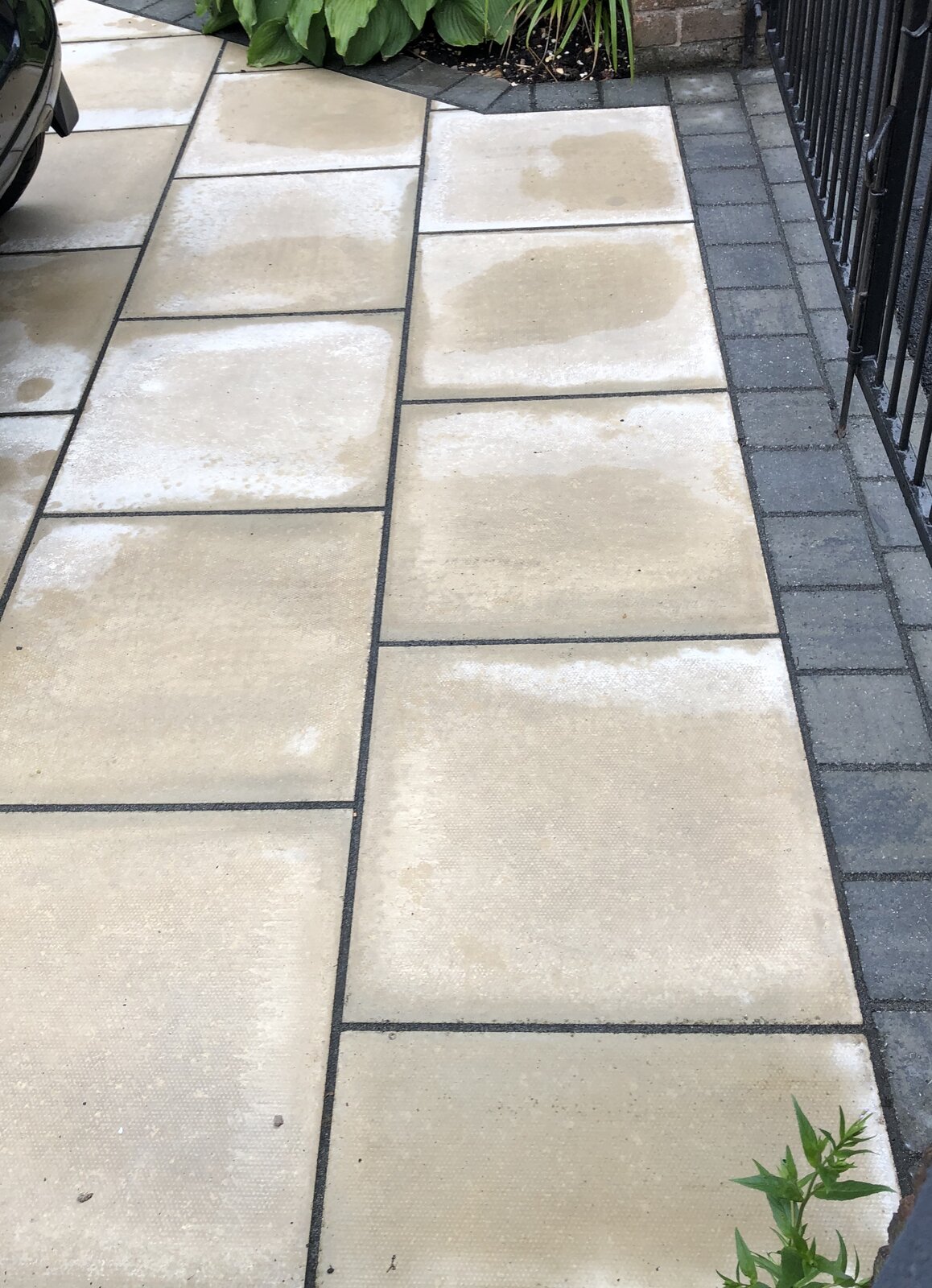

Does anybody know what flags these are? I thought they were a basic Marshall’s concrete 50mm flag but they look a lot lighter in colour than the typical concrete light grey ones. I ask because I wanted to use the Marshall’s flags on my driveway but when I’ve seen them at my local landscapers they don’t look the same colour.
They look like Richmond buff to me, 450x450x32
If they are Marshall's ,you can get them at any Travis yard.
They need laying well for a drive and on a solid base or they will crack .
Ideally look for 450x450x50 or 60mm thick for a drive
They do have small pimples on them which have worn which swayed me away from Richmond. They just don’t look grey enough to be Marshalls
There buff, with a lot of efflorvessence..I cant be bothered to google spelling.
So look at standard paving in buff, usually 600x600x50
I ask at travis ect,as they may know of another size in 50mm buff
Thanks. How’s the effervescence been caused? Maybe not SBR ing the backs?
Cement causes it, usually short term problem.
You can use a diluted cement acid wash to clean it ,but better to allow it to go naturally.
