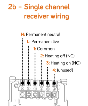

Can anyone help please with the wiring of the Hive Receiver. Presumably this replaces the clock, which has normal Live and Neutral plus two other wires, white and brown, which I presume are Heating off and Heating on, but which is which? Do I have to join a cable to the "common" in the Hive Receiver ? I realise that I will have to replace the "link" in the boiler wiring, which I removed when fitting the room thermostat 6 year ago. The boiler is Heating and direct hot water i.e. no hot water tank. Thanks Peter
