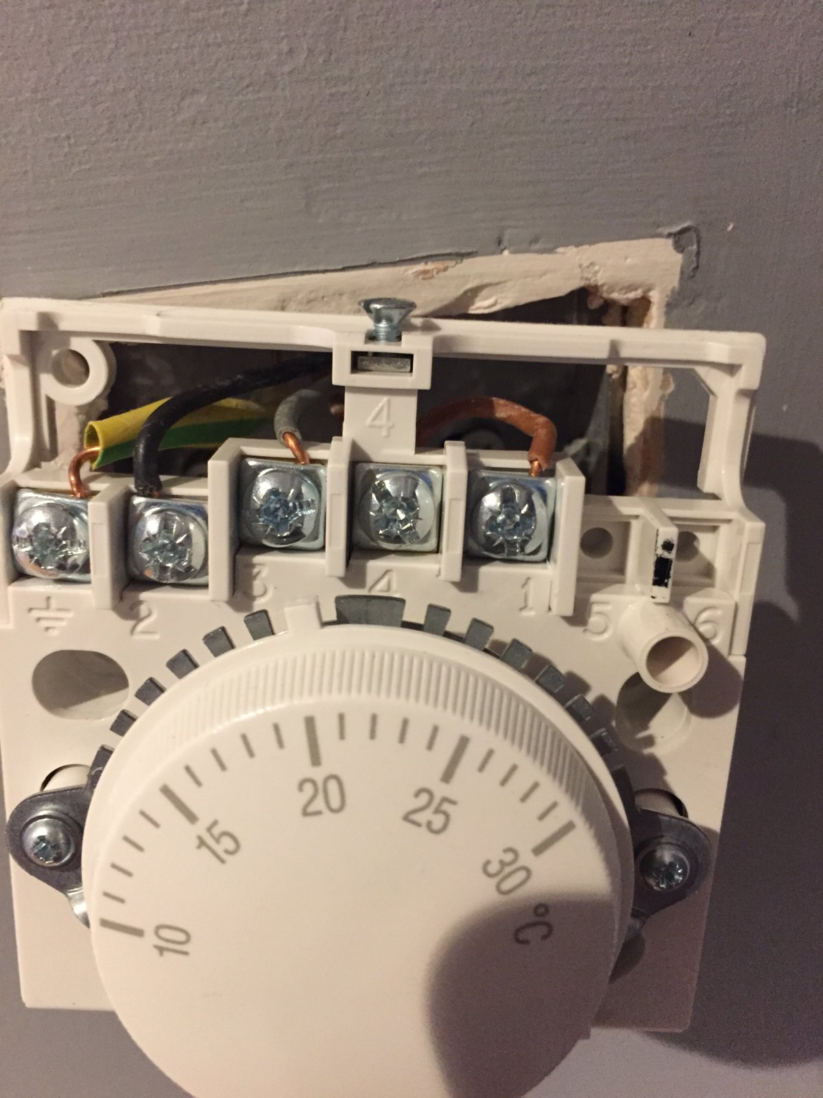

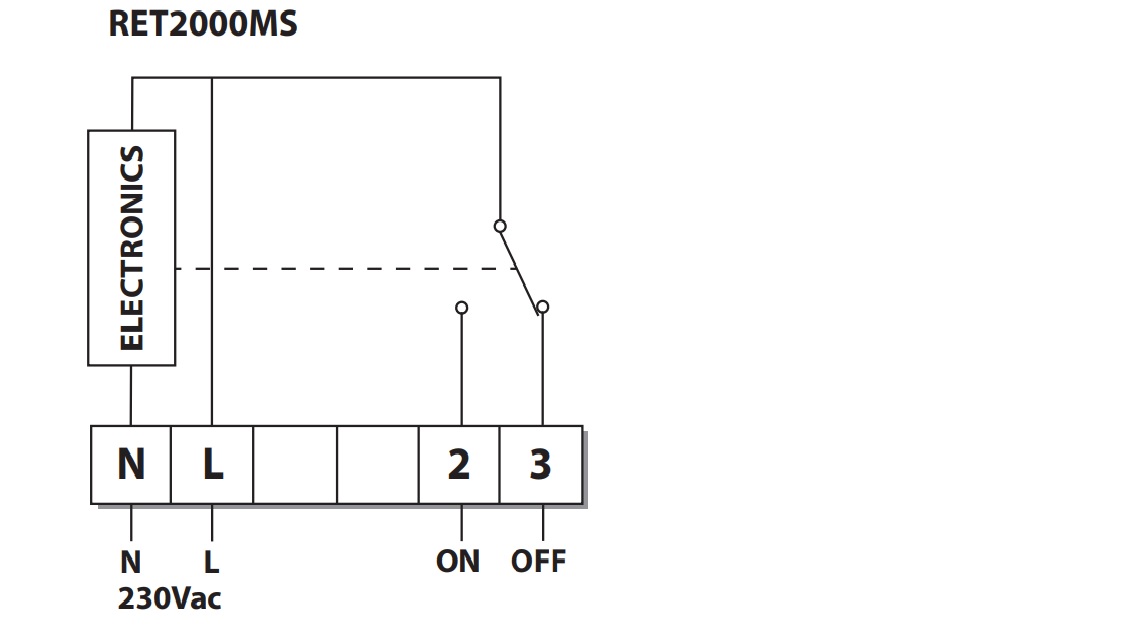

I'm have bought a Danfoss RET2000MS to replace an old analogue Honeywell T6360 thermostat. The Honeywell has four wires in terminals, brown T1, black T2, grey T3 and green/yellow earth terminal. Terminal 4 is empty.
Question - where do these wires go in the Danfoss RET2000MS?
Brown in Honeywell to L in Danfoss
Black in Honeywell to N in Danfoss
Grey in Honeywell to 2 in Danfoss
Terminate earth in a connector block
