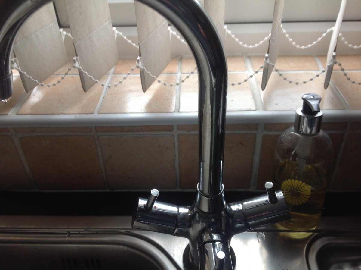

How do I change washer(s) in this tap ?
13 Oct 2006
278
2
Worcestershire
Q
hi guys,can someone point me the right direction to dismantle this tap so as I can change whatever is causing it to drip.....as I cannot see anything that I can actually undo.....many thanks in advance
The spindles should unscrew and have a grub screw that holds the main tap handle on, no washers they are quarter turn ceramic discs.
If there are no grub screws anywhere, even on th underside, try pullong the heads off. Or getting a thin flat blade in the join and easing off.
Try removing the coloured inserts to see if there are any grub screws beneath.
Otherwise try pouring boiling water over tap heads to expand them.
