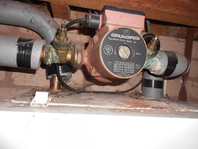

Potterton Boiler in the garage. Open Vented I belive. [Loft has Expansion & Feed Cistern]. Above the boiler a pump connected to the return pipe.

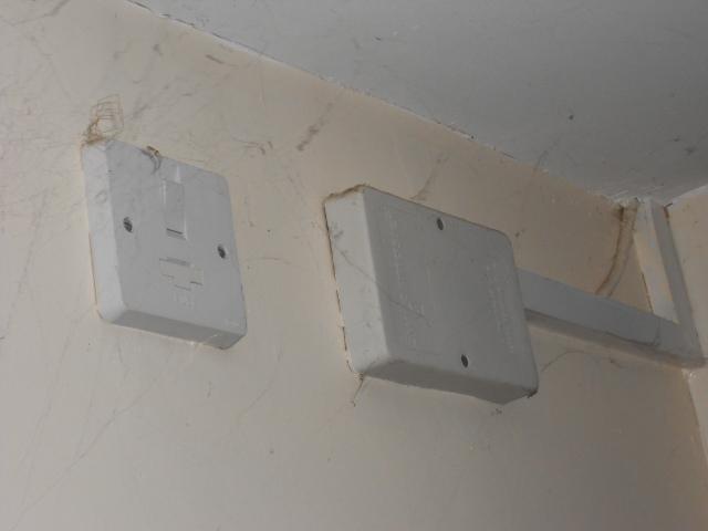

Electricity supply to the boiler & its associated equipment is in complete isolation in the corridor. Fig 1.

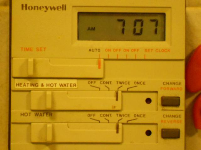

In kitchen a Honeywell Timer. Timer has two choices- "Heating & Hot Water " or "Hot Water" See Fig 2.

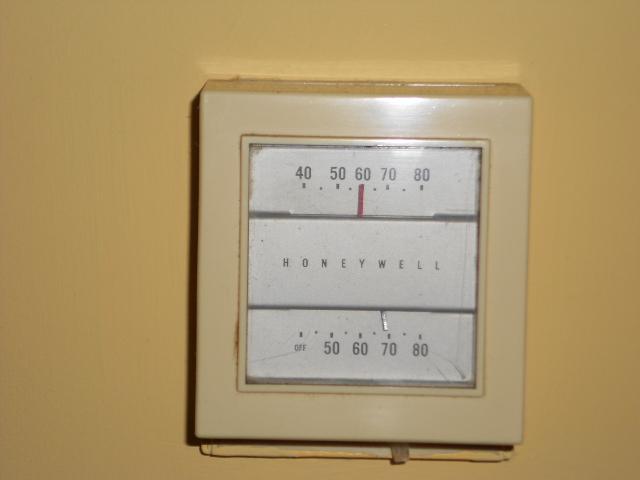

In the hallway situated a Room Thermostat. See Fig 3.

When ever the water alone is selected for heating, the radiator in the bathroom get heated too but not other house radiators. This bath room radiator is connected to the hot-water tank in the airing cupboard.

2. When hot-water tank is heated alone by selecting a choice in the Honeywell control in the kitchen,[without the "central & water heating"] how does this happen? A valve bring about this control I suppose.
If it is a vale where would that valve be situated?
Is a valve mechanical one or electrically operated zone valves?

Disregard the gas supply, how many water pipes come off your boiler. A pic of it would help.
Thank you Pete.
There are two water pipes come off the boiler.
Pic attached:
What do you feel?
Regards
I feel my system is " Fully Pumped Open Vented"
Reasoning is
1. I can see one pump outside [on top] of my boiler.
So the pump does the circulation for the DHW [primary] circulation & radiator circuits.
But then I am unable to figure out as to how when I choose on my Honeywell timer to "Hot Water only", the DHW [Primary circuit] selectively heated up without my radiators warming up? This is my quandary?
Any suggestion to help me with my confusion
I think the pipe connection to the boiler, from the fig below, is clear there is no hot/cold pipes connected proximity to the boiler after the pump except the main 28mm Flow & Return pipe.
My pump is connected to the return pipe on the boiler which transmits the hot water by being pumped to DHW [Primary Circulation] as well as radiator circulation.
In a gravity fed hot water I should be able to see a return and a flow pipe from and to a DHW -Cylinder connected after the pump to the boiler. This I do not see.

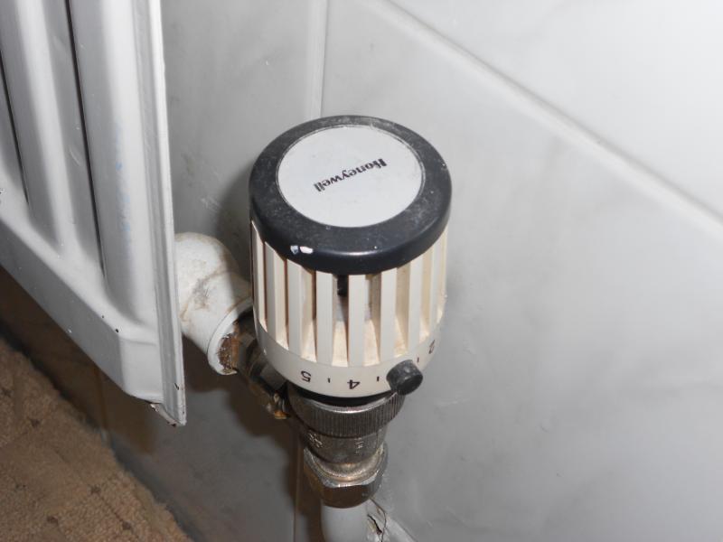

Only one radiator in the house has this and this radiator directly connected to the DHW Cylinder. Could this be the ?By-Pass Valve?
