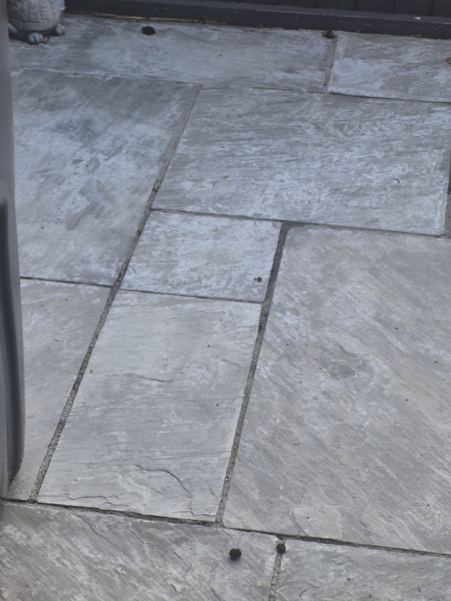

I laid my indian sandstone few years ago then couple months later i sealed it now it is very white powdery ive tried powerwashing it to get the sealer off.Any good liquid products to remove sealer?any help and advice will be great cheers

Not had this problem on IS, but I've used LTP products before, they will send out samples for you to try, and their phone support is good, they may be able to help.
Good luck.
LTP
Try soaking one tile with white vinegar overnight ( place rag over it to keep it wet) , may be a build up of limescale .

There are several liquid products designed to remove sealers from stone surfaces. Look for a stone sealer remover or a heavy-duty degreaser that’s safe for use on natural stone. Brands like Aqua Mix or StoneTech offer products specifically for this purpose.
