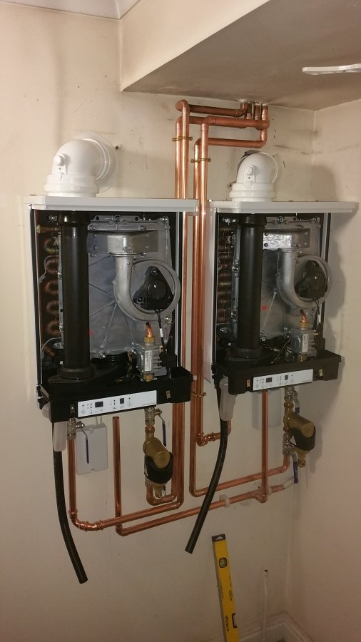

As above, you've asked about both a combi and an unvented cylinder, which generally wouldn't be fitted in the same house (although they can be, but it's unusual). Either way, Intergas is your answer ;-)
Okay guys, I've looked at the intergas site, and they look interesting, but you've suggested a boiler make without answering the other points.
And why do you love Intergas so much.
They can run open vented on the heating with no special measures.
Also being bomb proof helps.
Putting a brace into a big house at the moment.
10 year warranty too.
