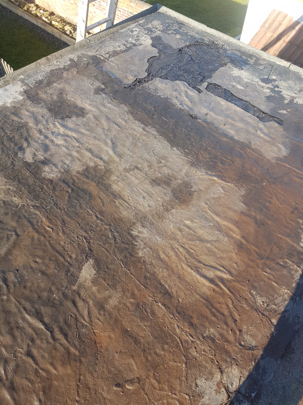

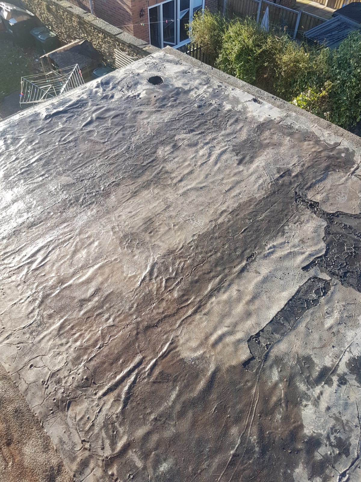

All, I'm currently working on my daughters house making it fit to live in. It has a 2 storey flat roof extension at the rear which was in a pretty poor state and leaking:

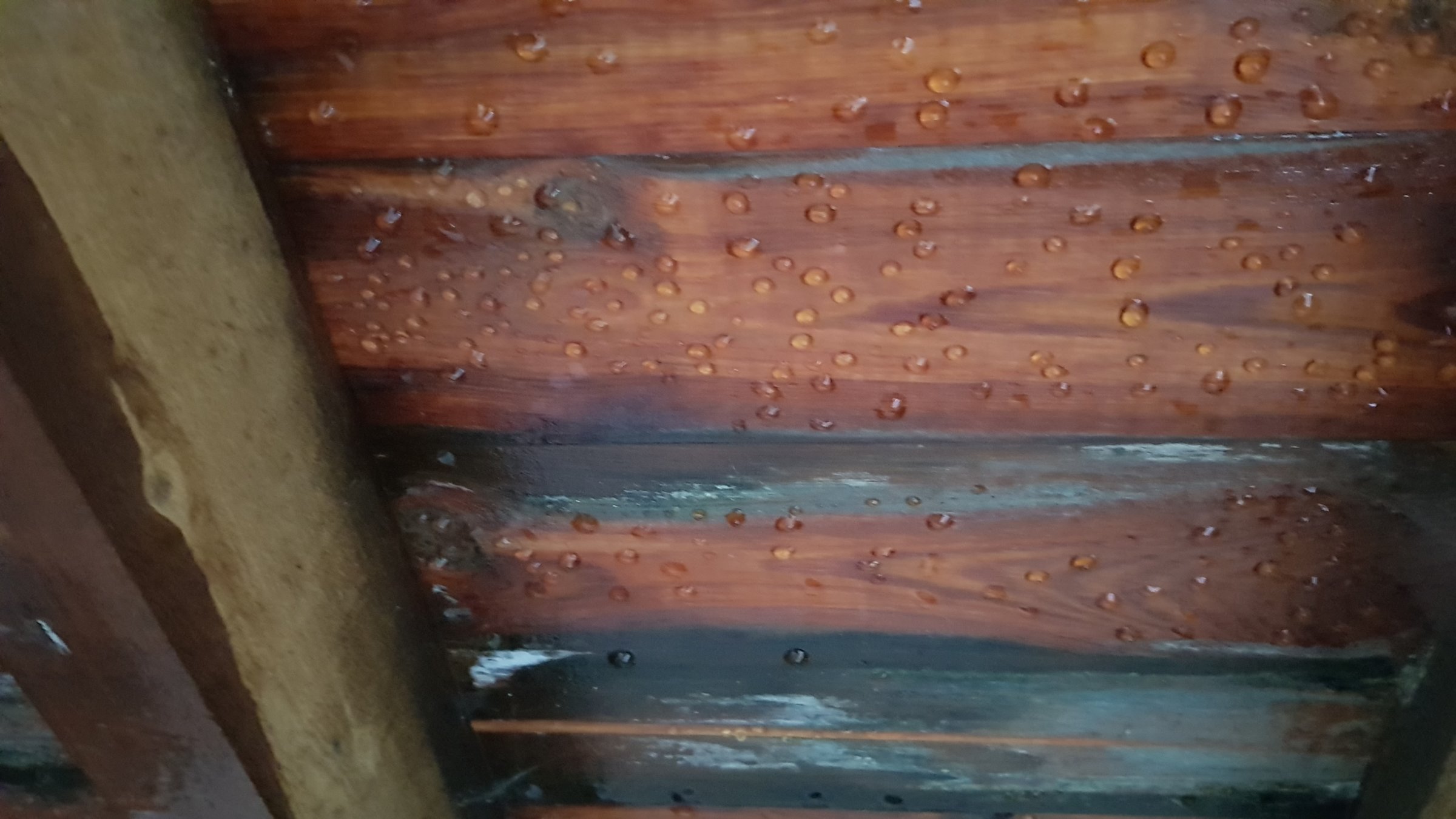

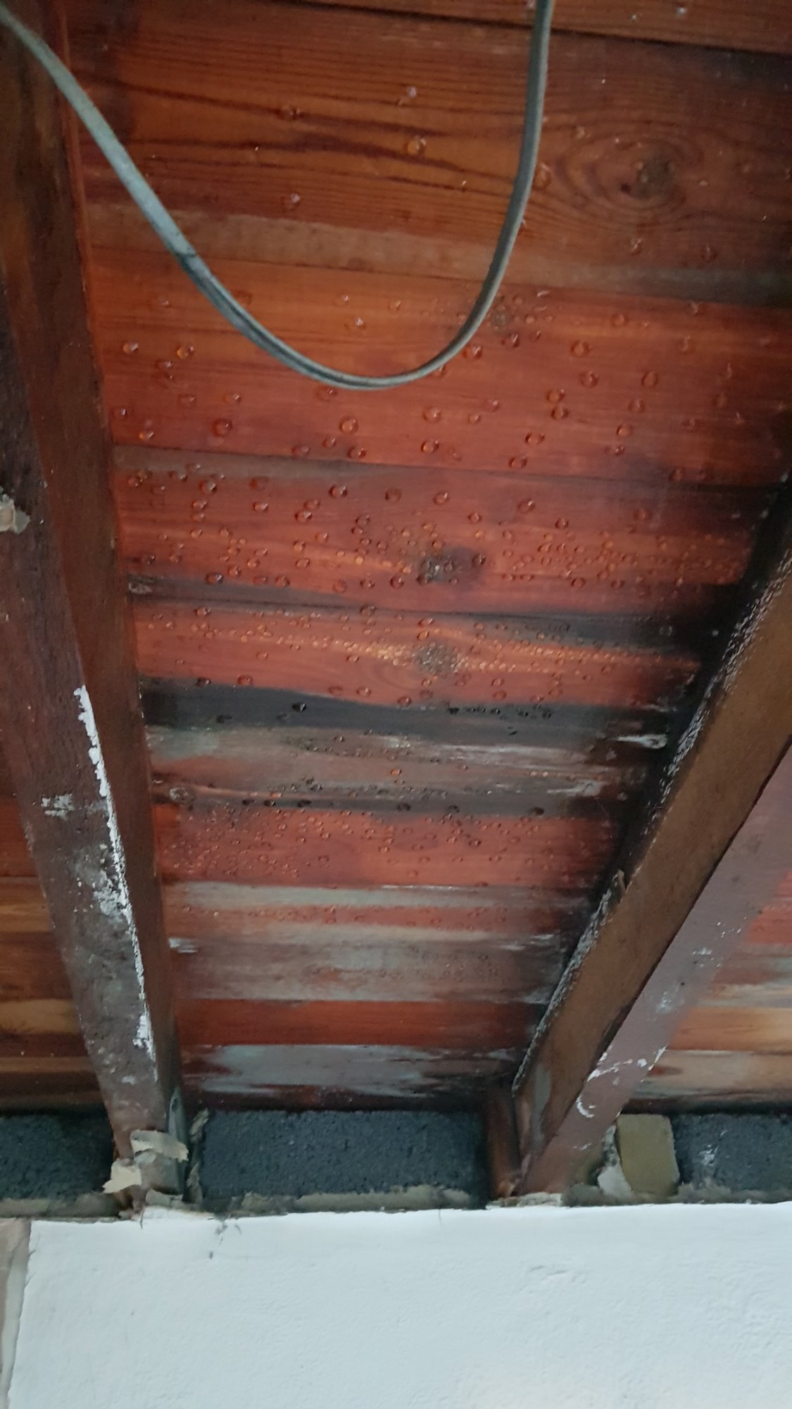

On the inside, there was evidence of moisture leaking in from outside and possibly more due to condensation as there was no insulation between the plasterboard ceiling and roof deck:

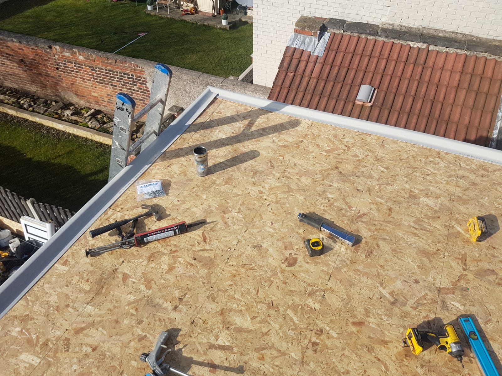

We've now repaired the roof and it's water tight:

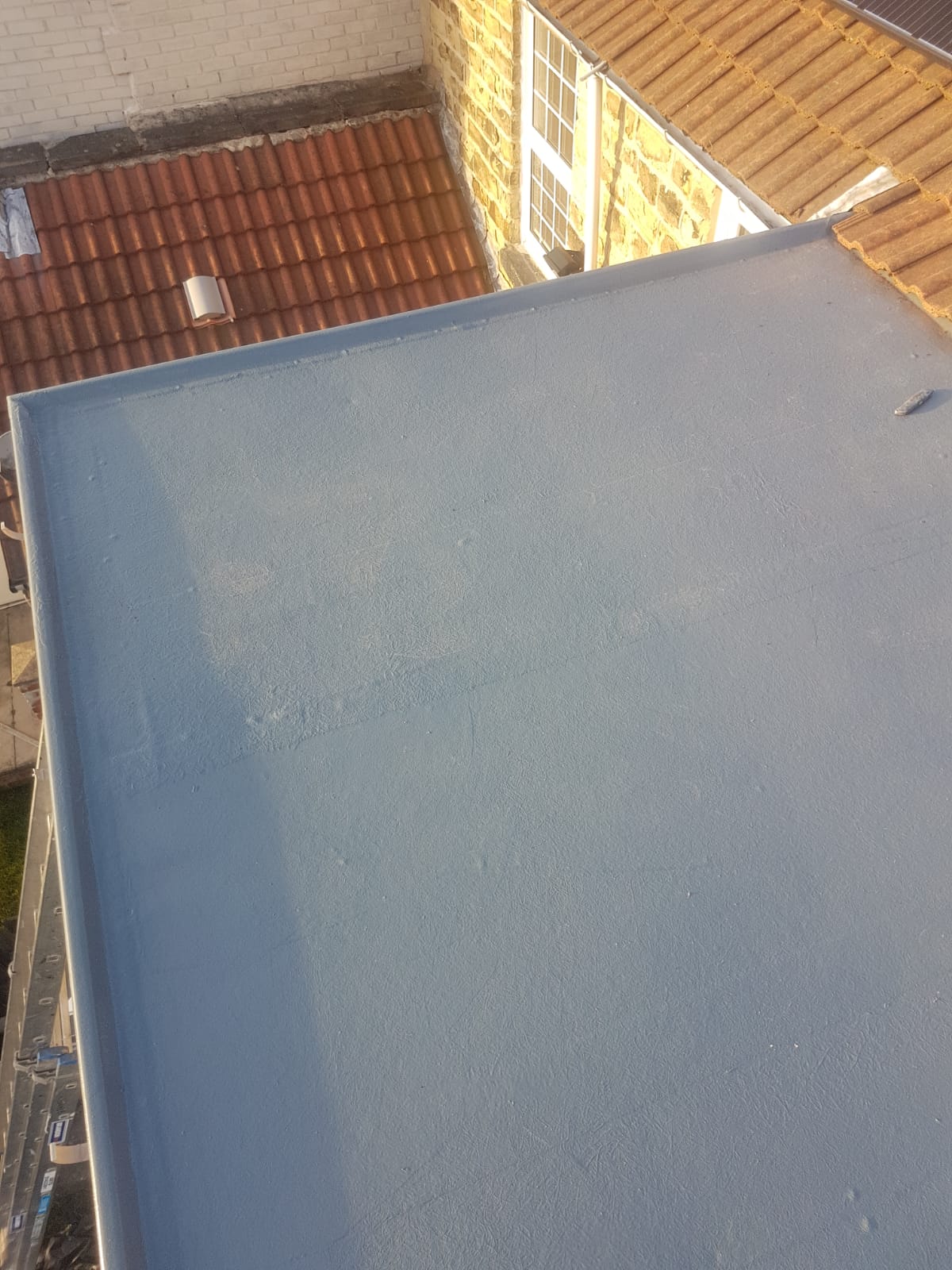

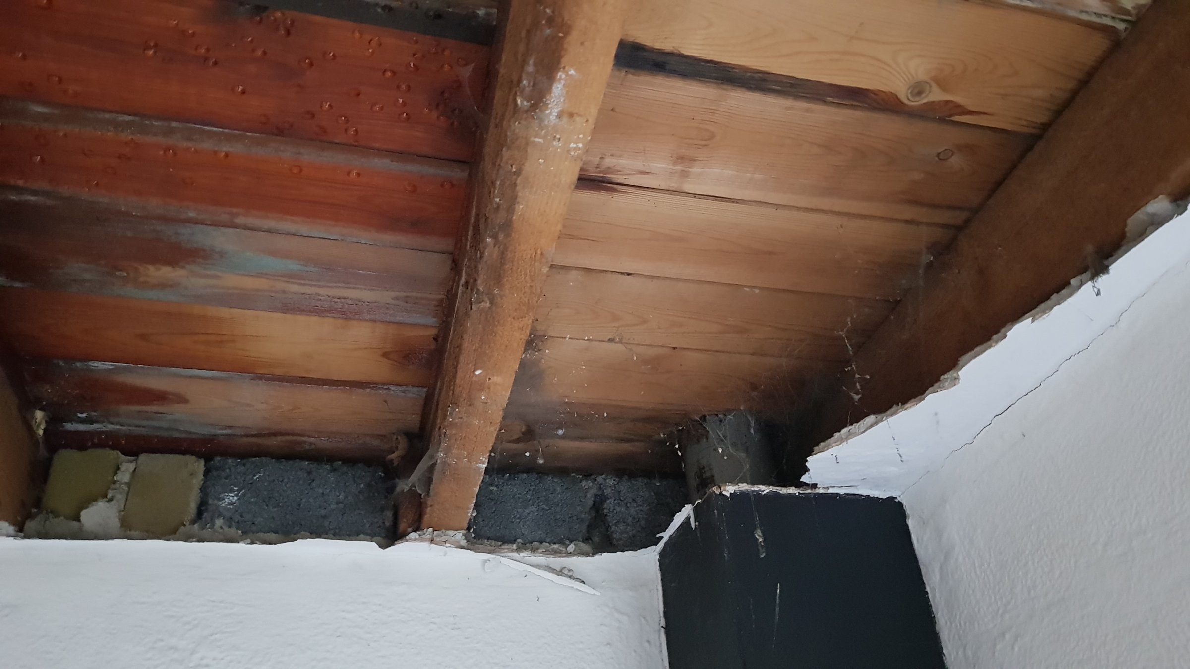

On the inside, the timbers are now fully dried out and mould free.
I have a load of 100mm Celotex left over from a previous project and I wanted to check what steps I should take before putting up the new ceiling. My thinking is that I put the Celotex between the joists, pushing it tight up to the deck, add a vapour barrier and then cover with plasterboard.
Does this sound right? If the vapour barrier is required, what should I use?
Advice welcome, thanks.
