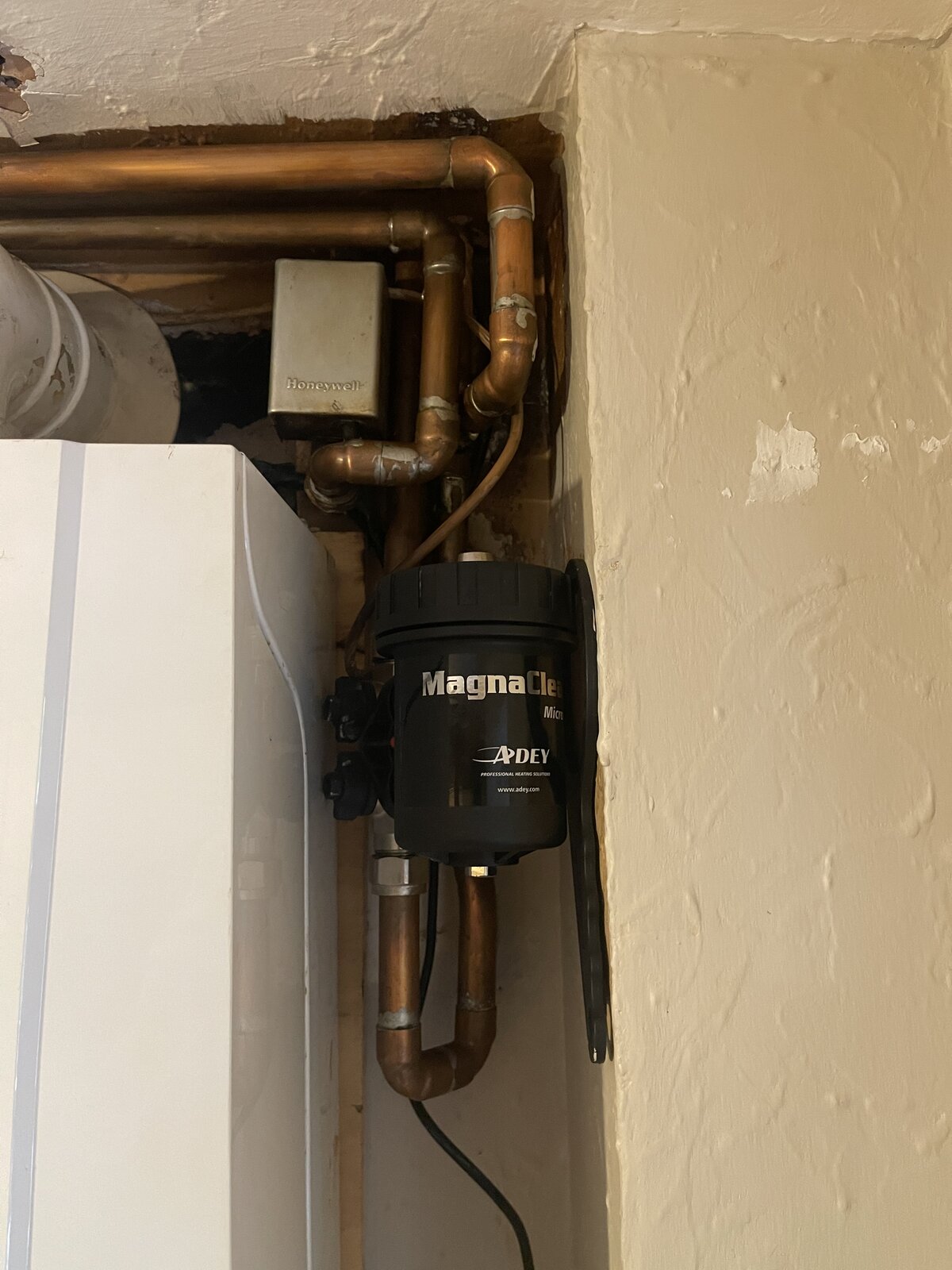

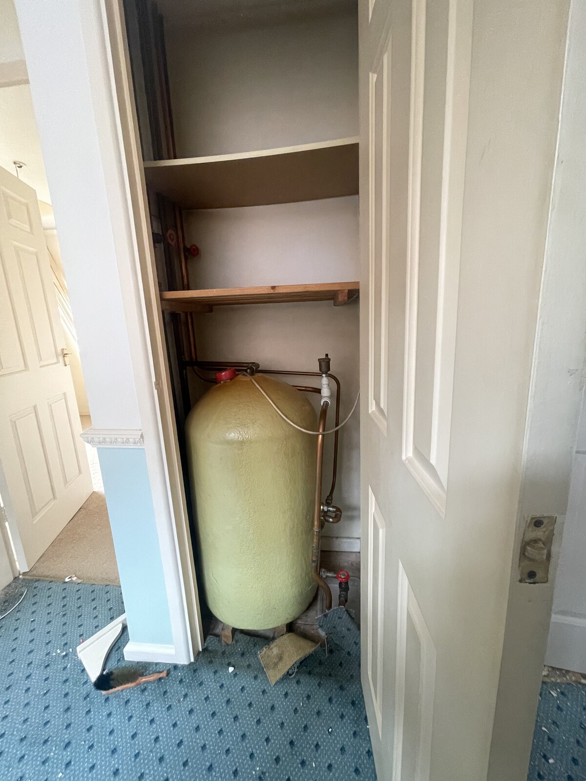

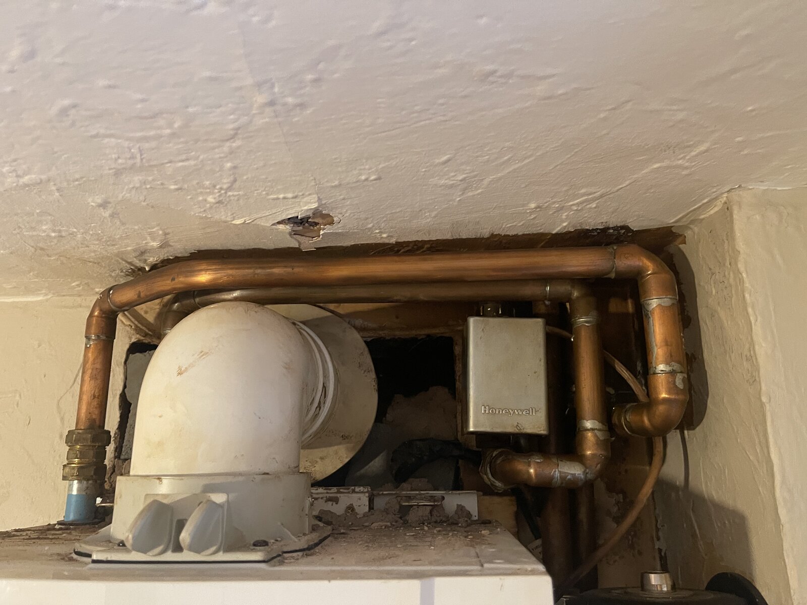

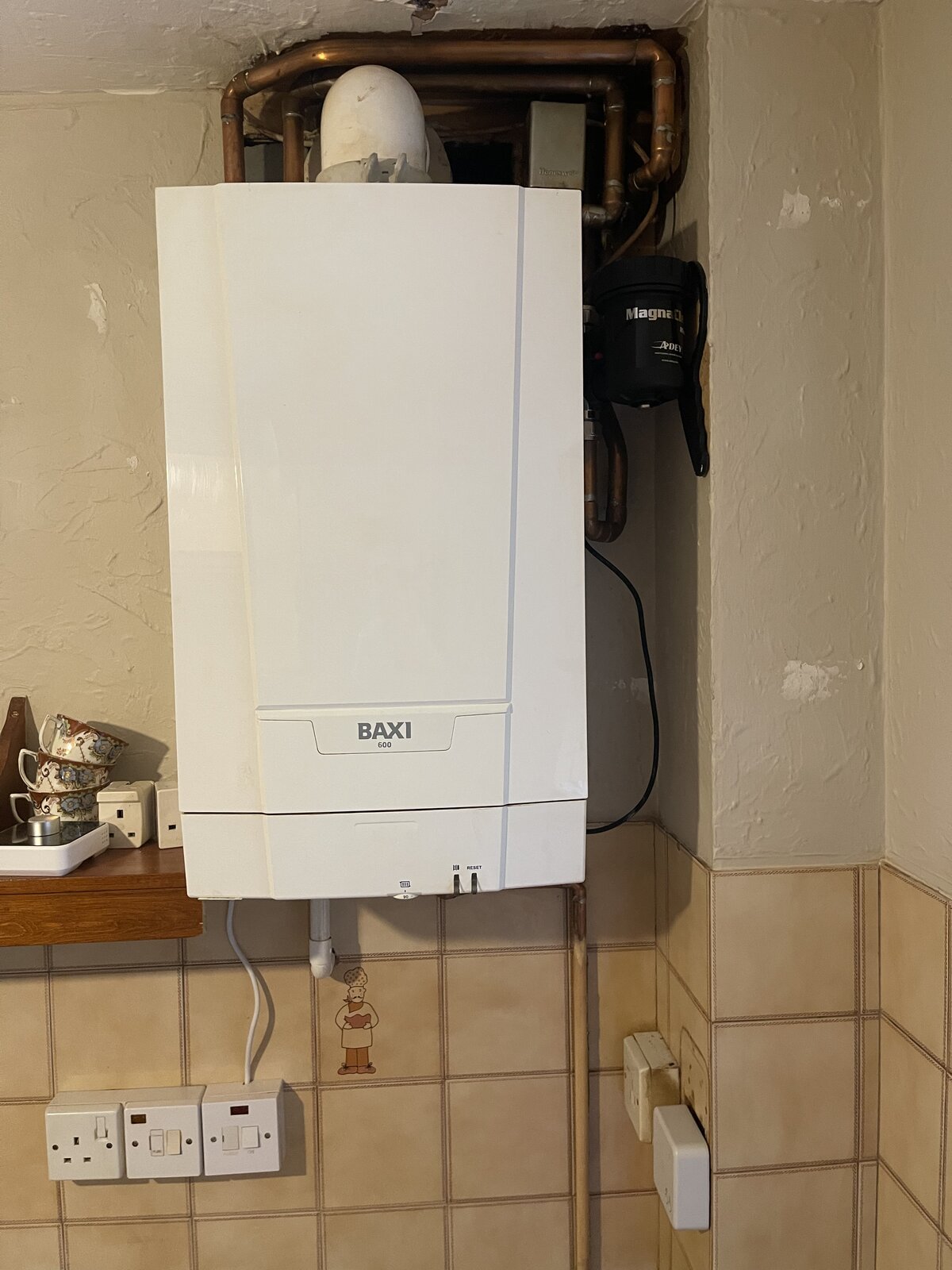

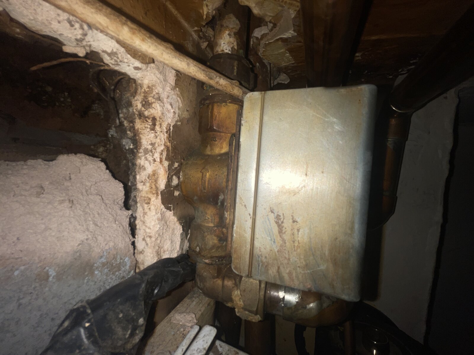

Trying to get my hive to work as currently I’m unable to get any hot water just central heating?

Your domestic hot water is gravity fed from a large loft tank,the boiler is likely to be also fed from a smaller loft tank ( f&e cistern).
Your central heating is fully pumped ,as is the coil inside the cylinder,that heats your domestic hot water. The flow to either and /or both, is controlled by the motorised valve in your pic .
