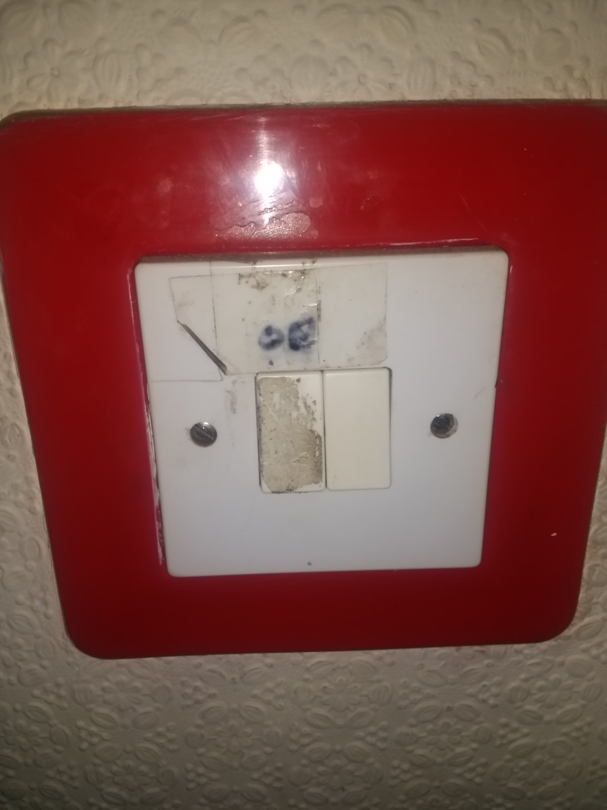

The solution is....... Sellotape.
I have the same issue - a cheapo rewire left my back light on the kitchen switch (and wired upside down) and my front on the HSL. My wife and kids just operated the switches at random. The black marker (needs redoing) was up light, down light and outside light arrows! Hopefully it will all be sorted soon but it's been a useful "temporary" arrangement for the past few years! Obviously in the old days they didn't have PIRs just switched bulkhead lights.
Yes, Sellotape solves many problems. We have some on our freezer power socket switch after it has been turned off a few times. Regarding the 2 gang light switch originally mentioned on this posting, I have successfully replaced it with a 2 gang switch where one switch is key operated. So far it works very well.[/QUOTE]
