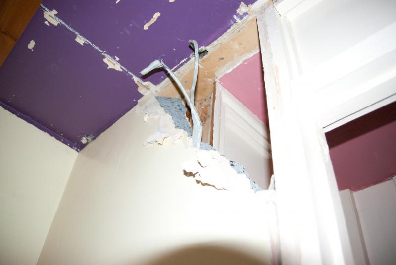

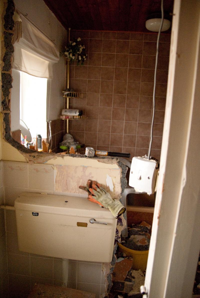

A work in progress - so far:
before:
during:
after:
I think I now know what happened to all those unemployed pillbox builders after the war - they went on to build council houses! For a non load bearing interior wall, it put up a fair fight! At least it seemed that way to me. Those aren't breezeblocks - they're cinder/concrete.
Plenty of SDS chisel and persuasion with the club hammer needed.
Next steps:
Core drill through the concrete exterior wall, avoiding the (steel) mains riser which passes next to where the new soil pipe will exit. Hope to get away without having to replace that steel pipe. Will be interesting to see if the cheapish (erbauer) diamond core bit I got will be up to it.
Then (and in one day as its the only loo), add branch to soil stack, and install new loo in its new place, and get rid of the rest of the wall.
