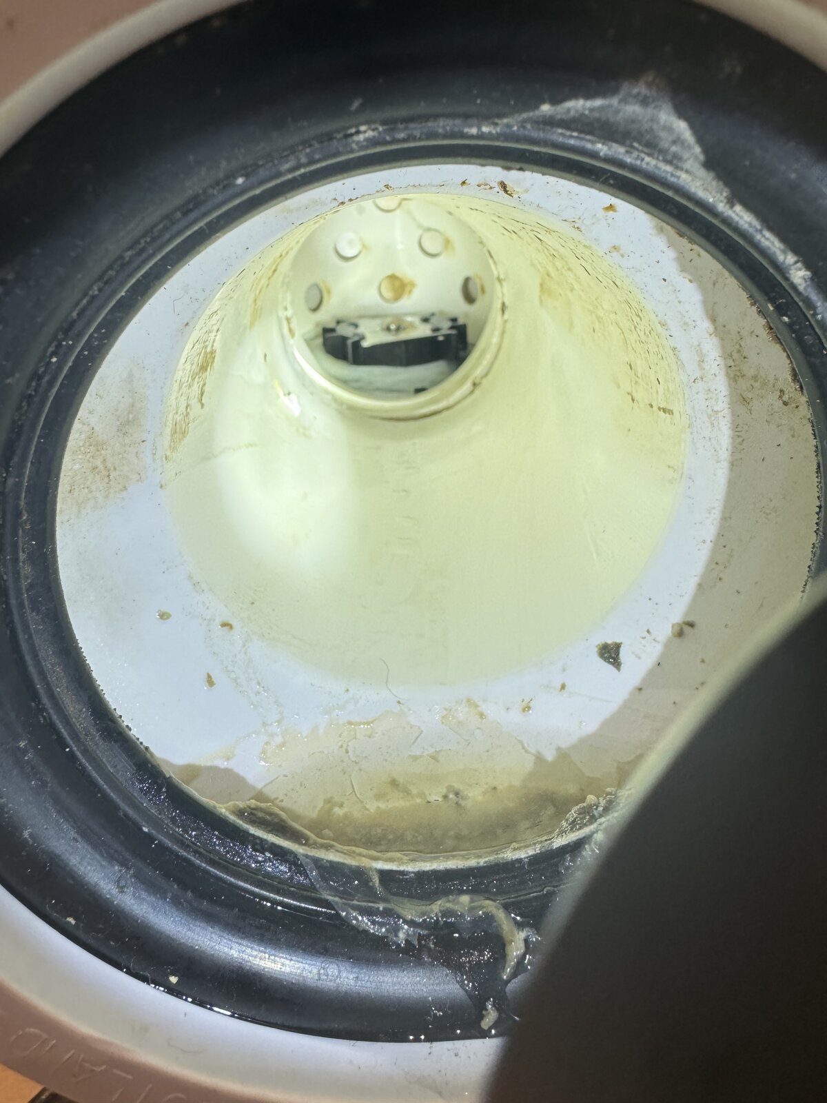

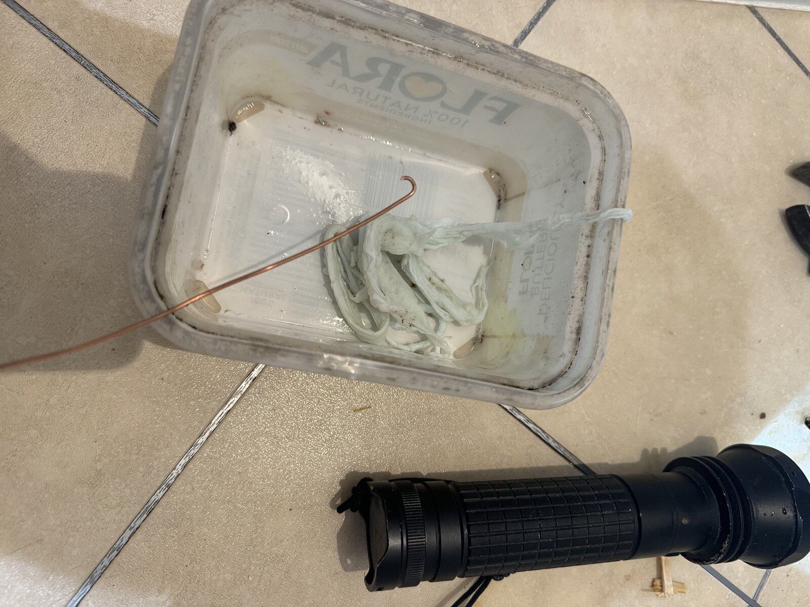

Thanks again to @just pumps. This is the second time you’ve helped me out on this macerator. I turned off the water and electric, removed two pan screws and slid the whole thing out. I took a peek down the hole and saw the wipe wrapped around the blade holder.
I hooked it out with a piece of wire.
Refitted everything back together and it was back to its old whisper quiet self. :mrgreen:

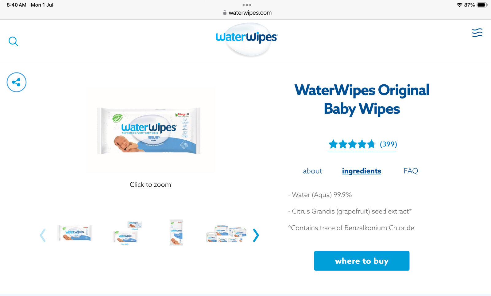

Actually, our 5 year old grandson asked to use the toilet, we thought it was just a wee. We heard a small voice call out - "I might need some help in here" as he’d done a poo and made a bit of a mess wiping himself. Our son went in, taking the baby wipes out of their baby's bag to clean him up and thinking he was at home, he just threw it down the pan and flushed. He then heard the death rattle and realised what he had done. These wipes are 99.9% water and allegedly biodegradable. Probably in 5 years though!
