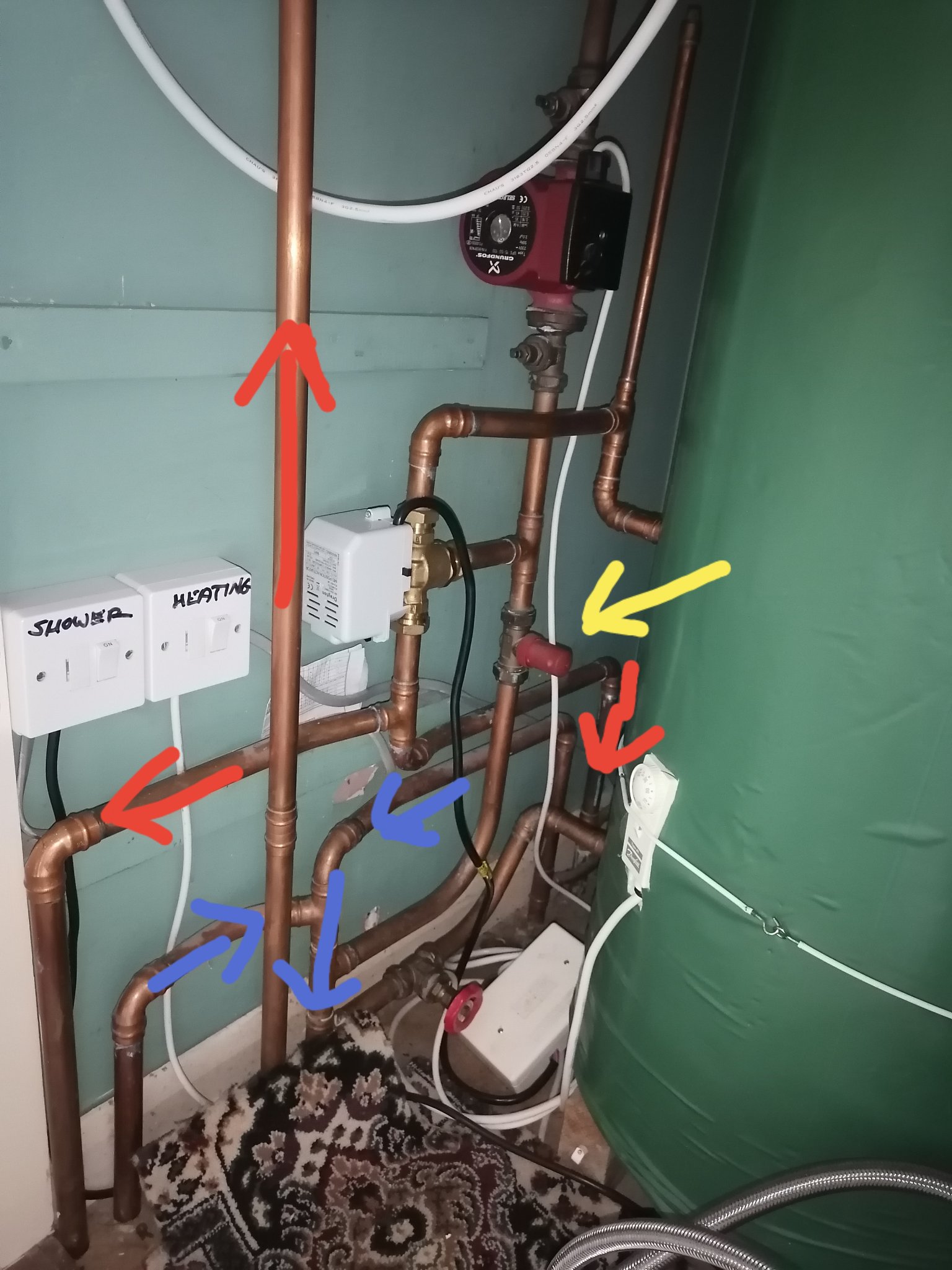

I have attached a pic. We have an extension so there are 2 return feeds going into a single boiler return pipe (all 22mm) in airing cupboard. I have attached a pic. Red vertical arrow is boiler feed pipe, red horizontal arrows are 2 central heating feed pipes. Blue arrows are central heating returns and boiler return pipe. My questions are:
1. Where would be the best place to install a magnetic filter? Could I extend the 2 central heating return pipes upwards to create a big enough gap between them and the main boiler return to fit a filter?
2. The yellow arrow. Is this a bypass valve? If yes, can the filter go before this or does it need to go after this?
Thanks in advance for all advice.
I assume there are no more rads returns coming in below the airing cupboard, as this would break the rule all rads returns must be commoned before the cylinder return joins.
In principle, but it would be quite fiddly.
Doesn't matter
The usual place for a filter is the CH return, so it stops crud entering the boiler. I suppose the pipe with the red arrow going straight up is the boiler flow. Don't know what the pros on here think, but putting the filter in that line is an option. It would still do some good and the system has managed without one for years.
Where are the open vent and cold feed, above the pic, maybe in the loft? Pumping downwards isn't ideal. With open vent and cold feed rearranged the pump could go in the upward pipe.
With the pump where it is the power lead going in the top isn't ideal. The flow direction is determined by the pump body, not the motor, you could rotate the motor 180°, just 4 Allen bolts.
The thing about sticking it on the return is purely a sales pitch the filter doesnt collect a great deal on first pass of water so it actually passes through the boiler thousands of times a day god knows how many millions of times in a year so if you can get it onto the flow before the pump then this will be perfectly ok .
Thank you both for the replies. It is greatly appreciated. I think it might be best putting it before the pump, as you say gas112.
Fixitflav - yes, the cold feed is in the loft. I am not sure whether there are any more radiator reforms between the airing cupboard and boiler, but I would guess not. It looks to me like the central heating for the extension feeds into a common return here before returning to the boiler, but I can't be 100% sure.
It's good to know about the motor lead. This was recently replaced by a local plumber so I assumed it was correct.
I meant where does it, and the open vent, connect to the circuit. But if the system works OK probably not worth worrying about pumping downwards.
If there are, the some rads will get warm when HW only called.
The terminal box is fitted so the lead is into the bottom when pumping upwards, that's why the writing is upside down. The plumber could have done the 180° turn before fitting the pump. It's not a big deal, but if the system is drained to fit a filter it could be done then.

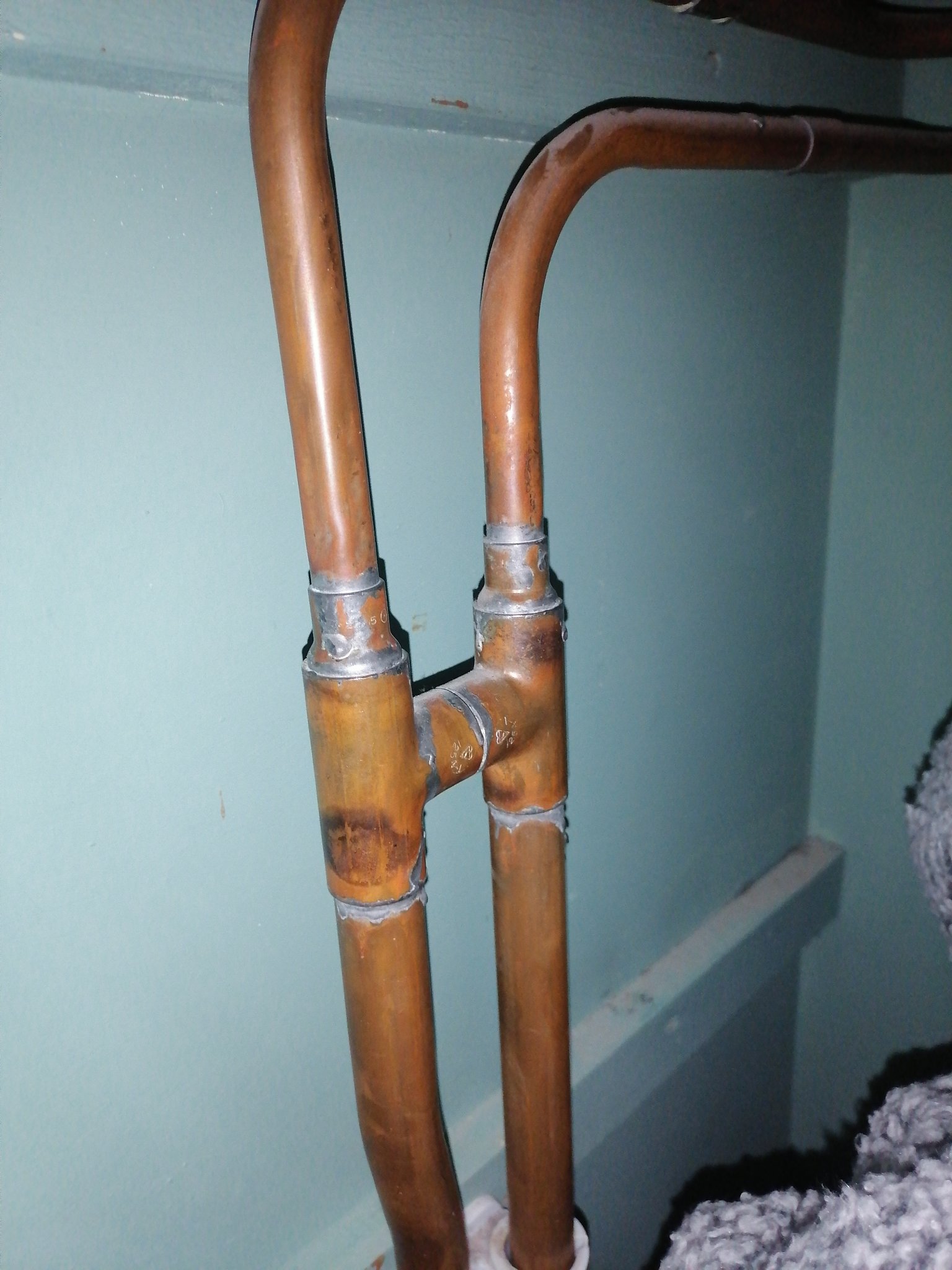

I've attached a pic. 22mm pipe at the back of the pic is the boiler feed pipe coming up from the floor (the one with the red vertical arrow in the previous pic). The 15mm pipe above this is the overflow/vent. The pipes at the front of the pic are the cold feed and CH feed. This pipe goes down into the pump.
I've read that this area can accumulate junk so I've put a magnet on this section and it is magnetic indicating there's a build up here (the system has been pumping over to the loft tank). I think I'll put the filter here as can't find anywhere else to put it, and can also clean this section whilst I'm there.
Did you mean the boiler flow pipe?

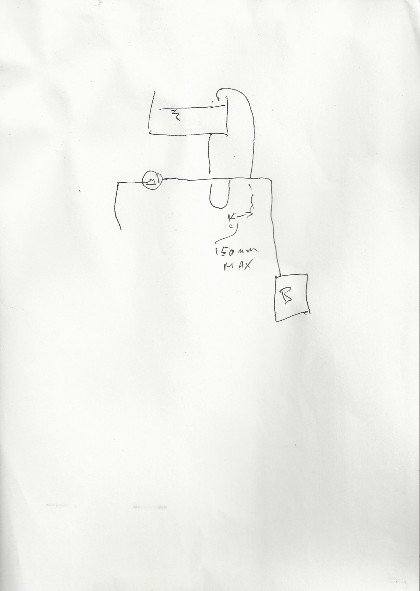

I wouldn't pipe the open vent like that, across the top of a tee, as it gives a head start to water into the vent, encouraging overpumping. Better to take the vent from the top of a horizontal run.
I would do it like the attached sketch, the cold feed up and under, to reduce convection warming the F/E tank aiding algae growth. The filter could go in the boiler flow, before the vent, or after the pump, whichever is easier.

Boiler installation manuals, if they include a piping layout, usually but not always, show cold feed up and under. The thing about not taking the vent from across the top of a tee is my own idea, but I believe it reduces the tendency to overpump.
