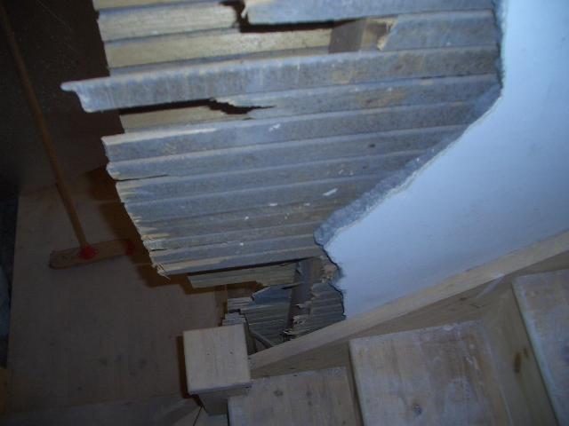

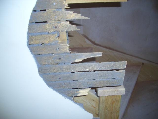

I have knocked a hole through an existing lath and plaster wall( plaster is sooty render with skim really ':evil:' ) in readiness to get the stairs up to our loft.
The plaster has come of a little more than wanted so will strip back to the next stud so the lath finishes on a stud and not mid span
If i fix a new stud and then a timber lining to form a 'stop' at the opening created could I infil the gap between the existing stud where the lath finishes with plasterboard and skim over? A bit worried about cracking between the different types.

You can make good with plasterboard. Skim with multi finish adding a good cup full of lime to the mix. Will take longer to go off and the finish will be a weaker finish but it will be more flexible because of the lime content.

the reason i asked for pics is if its just plaster coming off with a few exposed laths then this could be patched without the need for boards ect, if you can post some pics then people on here would tell you exactly how they would fix it using the best method
I'll try over the next few days as this isn't being completed until next week once the stairs are in

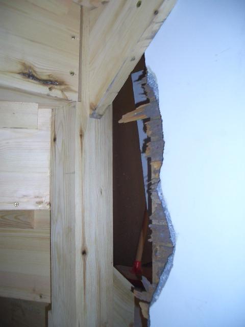

o.k. finally got around to adding some pics!
I will be putting another stud in next to the newel post
I have a plasterer in who reckons it will be ok to tidy up the lath and plaster and renail and then piece in some plasterboard for a final skim over...would be intrested to know some further opinions

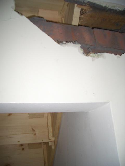

the last pic is some of the bulkhead we had to take out to get the stringers down. I am assumming somthing similar with piecing in plaster board in and then skiming as the existing render is as thick if not thicker than pb.

What's wrong with replacing the laths and then plastering with proper lime plaster - especially if your building is essentially built with lime mortar.

Hammer fixing the lath is likley to damage the existing plaster even further

I have tidied up the laths with a recip saw - If the plasterboard works then this will be easier and will patch in where needing with some carlite and the plasterer will finish with skim coat
Laths can be bought from lots of companies who sell lime products e.g. Mike Wye in Devon (find them on Google).
You don't have to nail the laths, you can screw them which is what I did where I was doing repairs as opposed to doing the whole ceiling.
