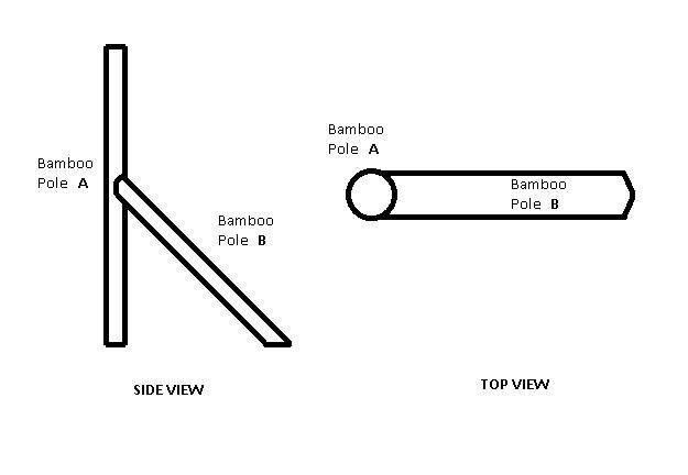

Right, think about two bamboo poles laballed A and B. Bamboo pole B meets Bamboo pole A (somewhere in the middle of the pole) at an angle 45 degrees. Bamboo pole B has an outer diameter of 30mm and Bamboo pole A has an outer diameter of 35mm.
So I then take a hole saw with diameter 35mm and drill a hole in Bamboo pole B, at an angle 45, using a drill press to get an accurate hole. The holes are made at either ends of the pole so no I am not running a pole through another pole. Once the hole is made Bamboo pole B can fit snugly around Bamboo pole A. At this point I use epoxy resin with some micro fibre and make the joint strong.

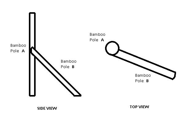

Now sometimes the holes are made at say + or - distance for the center of the pole so say if the same Bamboo pole B was joining the Bamboo pole A at the same angle 45 degrees but this time it is joining the pole A diagonally at an angle 30 (say if you were looking at the joint from the top). I am getting too technical here but here are a couple of sketches to show what I am doing.
This sketch shows the case when I drill through the Bamboo pole B at 45 degrees with 0 offset.
This sketch shows when I drill through the bamboo pole B at 45 degrees but with say 5mm offset from the centre.
I hope this makes it clear now as to what I am hoping to achieve with the drill press situation. The base that I am thinking of making for the drill press vice should allow me to me to go in both x and y directions to get precise holes. The protractor will come handy if it was somehow fixed to the tilting table and give me perfect reading on the angles.

I think I see what it is your trying to do and how, please correct me if I'm wrong.
Below is your sketch adapted :
View media item 58648
the red shows the direction of movement of pole "b" if this is correct what you are trying to achieve is a scribe joint at a skew angle, tangent to the side of the receiving pole "a" and you choose the hole saw to suit the receiving pole "a" cutting "b" at the designated skew angle and offset to "a" phew is that right, if not what a waste...pinenot
Yes that is correct pinenot. I have now found an easy way to sort this problem out... I got myself a inclinometer which tells me the exact angle so I go the angles sort this way. Secondly for every hole I am gonna make I will be using a pilot drill bit and set my offset using that instead. So sorry guys for making this a complicated situation I think I will be better off with simple methods in the future. Cheers
