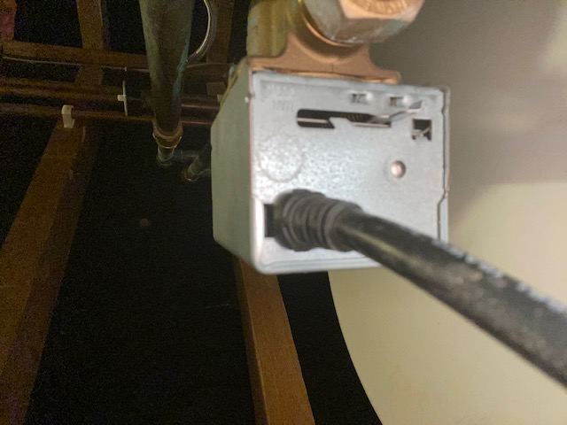

I have a central heating and hot water system that was installed a couple of years ago, and works, providing heating and hot water as it should . That should be the end of the story, but the loft space ( 10 cubic metres) that the Worcester boiler and the pressurised hot water cylinder are installed in, is very warm, to the extent that it overheats the adjacent room quite considerably. It has always been hot as far as I remember. Today I did a bit of investigation.
The flow and return pipes to the boiler are constantly hot, even without heating being on, and when no hot water has been used for some time. The motorised valve controlling flow of hot water to the pressurised cylinder is always open, ie the lever is loose, and the pipes both sides of the valve are hot. Every ten minutes or so the boilers internal pump starts for a few minutes, but without heating. It appears from the boiler display that the pump action reduces the water temperature of the boiler and then switches off. Full disclosure, the boiler thermostat ( which controls both heating and hot water) was set to about 70 and I have reduced it to the 'eco' setting of 55, which may account for why the cylinder water temperature is higher than the boiler wants it . However before I reset the temperature, the motorised valve was still open and all the pipework was hot.
So I surmise that because the hot water motorised valve is open all the time that hot water from the cylinder is free to flow through the pipework to and from the boiler.
Any ideas why this valve would be always open, without the boiler firing up for heating. Or any other diagnosis I could check for. ?

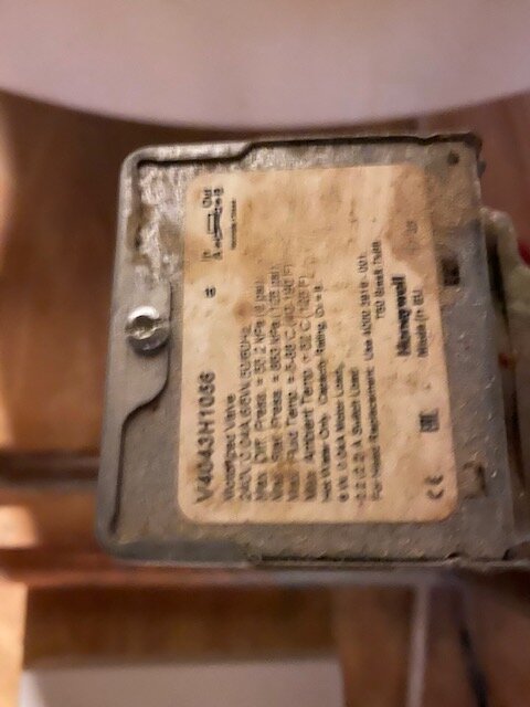

Photos of your setup including all motorised valves, programmer and pipework between boiler and cylinder would help.
If the valve is always open, as in constantly firing up the boiler to heat, the microswitch is probably jammed open sending a constant live feed to act as a “call” for hot water.
Thanks all - just to clarify, although the valve is clearly open the boiler is not constantly heating. Presumably it does heat when the cylinder thermostat calls for it, as the system produces hot water. I suppose my first question is whether the valve being open in such a situation is an issue or not.

Turn the sused spur for the heating off, if the valve now closes it is a control problem somewhere, if it stays open then the valve synchron motor has seized unles it is a MOMO valve of course as you have already beed asked a pic tells a lot more than you are telling us
When the need for heat to the cylinder is satisfied (thermostat) or the time clock is outside the HW on hours, the valve should be closed. If not, then whenever the CH is on, it will be trying to heat the cylinder too.
Does the valve close, when the whole system is powered off - judging by your mention of it having a lever, it is a spring return type?
Thanks again guys
IanMcD - turning off power to heating system caused the valve to close. So as you suspect, a control problem rather than a seized motor ?
Harry B - it is a spring return valve. Photos attached. But as Ian asked too, the valve does close when the power to the whole system is turned off.

Thank you guys - it is the cylinder thermostat that is kaput. The boiler is filling the cylinder with water at about 60 degrees. I had to turn the cylinder thermostat down to about 30 degrees before it shut down the motorised valve and turned the boiler off. I then had to turn it back up to about 45 degrees before it turned it back on. It had been set to about 55 degrees, so would have needed water temperature of about 85 degrees to trip the thermostat. I guess that it should be switching on and off a couple of degrees either side of the set temperature - and needs replacing. Thanks for your advice - beers on me when your passing.....
